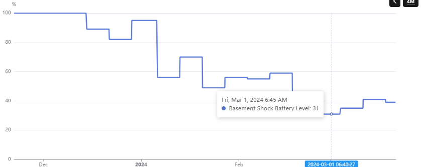

I have a Zooz ZS41 door sensor that appears to drain the battery quickly. I updated the firmware but no change. However, it’s being used to turn on a closet light which isn’t too critical, so I let it go with what appears to be “low” battery to see what would happen. 3 months later, with it reporting “0” battery, it continues to work fine. Perhaps Zooz has a problem with battery reporting and not with battery consumption? Or it could be both.
I think that’s largely due to the method most devices use to determine when a battery is low (usually voltage). CR2032 coin cells tend to lose voltage on a curve, so it’ll look like they’re depleting quickly, and then like they aren’t depleting at all. As you’re finding, the voltage might still be enough for the device to work, even if it’s below the threshold that is reported as 0%.
Some folks ignore the percentages and instead look at the reported voltage to determine when batteries need replacing.
I did put one of these (ZSE43) back in service 4 months ago with a new battery (non-critical location) just to see when it actually runs out (86400 wake). As noted above, rapidly down from 100% but still at 30-ish.
