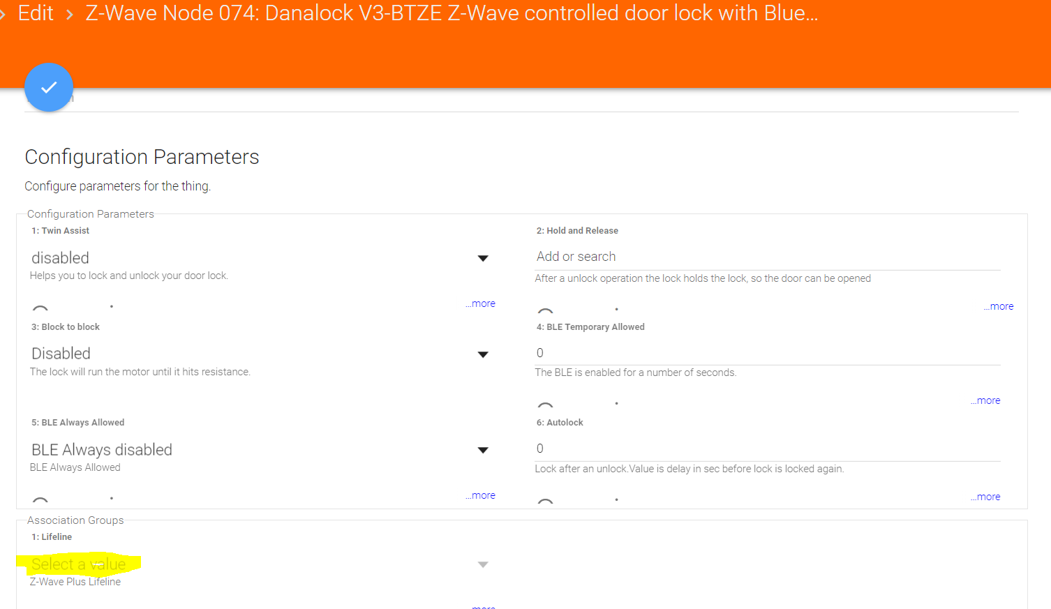

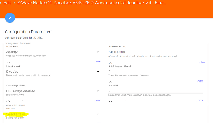

  • checked lifeline association (was empty in Habmin and PaperUI, set Controller as lifeline and saved, but didn’t help).

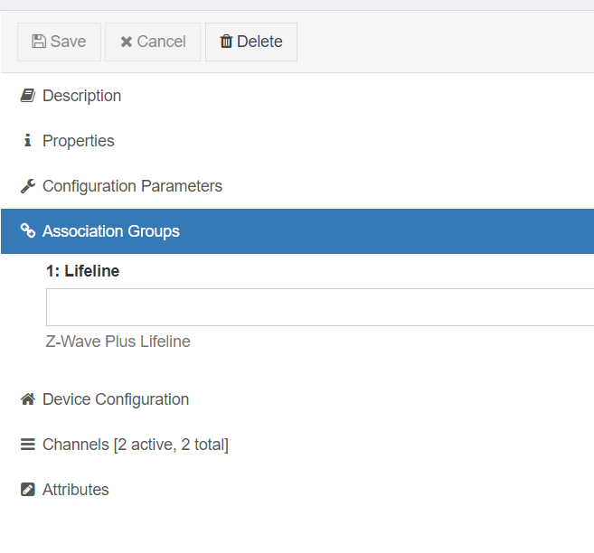

It seems, as if the Danalock always looses (or never accepts?) the lifeline setting. Because after a while and a reload of habmin (or paper ui), the lifeline is empty again.

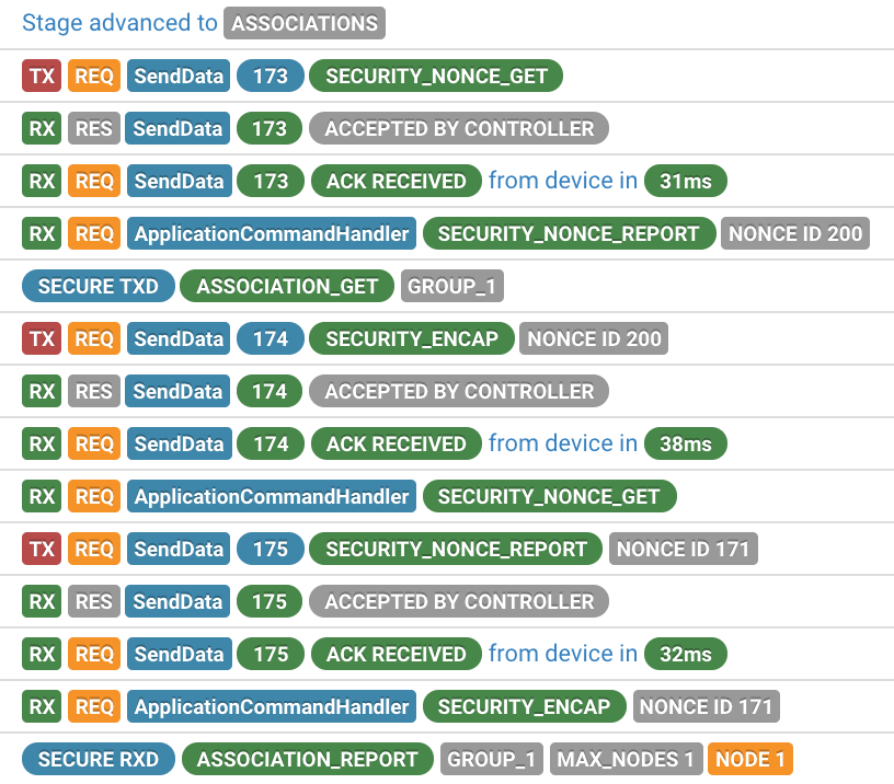

I don’t really see anything immediately wrong. The associations are being set correctly -:
This shows the lifeline group (group 1) being set to node 1 (the controller), and the report confirms that it is set correctly.

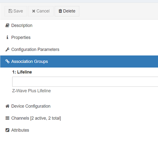

My assignment of the controller to the lifeline setting gets lost after each restart so that I have to assign it manually. Is there a trick to automise it?
Please ensure you are using the latest binding, and if it is really getting lost, then please provide a log showing what is happening. It could just be a display error with the UI.
