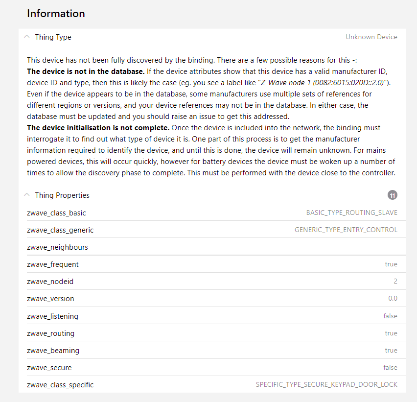

  1. Probably not the issue, but the device numbers I’m talking about are shown here
Sometimes there is a new version that needs to be added.
You need to look at the link I posted above for two reasons
  1. Check the device numbers match
  2. Your inclusion/exclusion description does not align with the instructions (Bluetooth app first?)
Bob
Dear @apella12 ,
Thank you for hint.
I have verified manufacturerId and manufacturerRef are not visible:
regarding app, i don’t want to have Bluetooth app, only control from OpenHab. Documentation states, that when I do pair with BT app, I will lost further access to Bluetooth.
