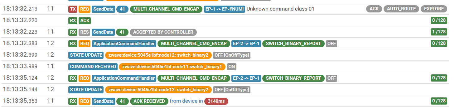

I have a couple of Fibaro FGS223 Switches which usually have fast response times. But sporadically there is a very noticeable delay between sending a command to the switch and the physical device responding.

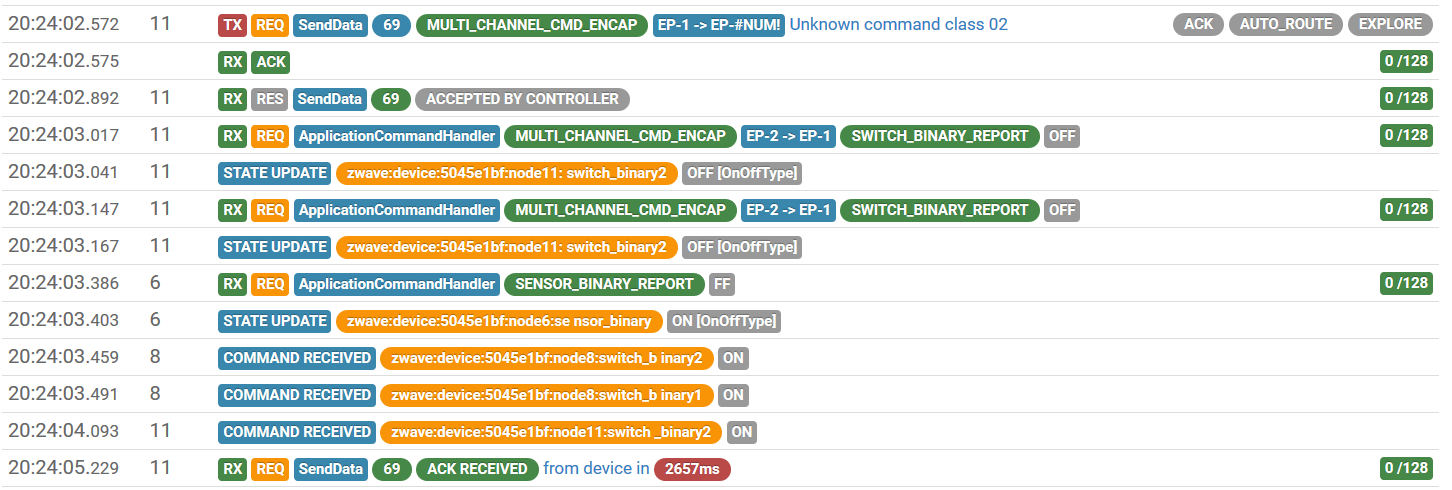

zwave debug shows significant delay between command TX and RX ack
I’m observing this behavior since months with various openhab versions and could not find any solution so far.
currently I’m running openhab version 2.4.0.M4 - but also with your new z-wave binding no improvement
This doesn’t look like a software issue - it just looks like the device is responding slowly. The binding sends the command, and then the device is simply not responding for a few seconds.
This might be because the controller is having to resend the messages which can happen if communications through the mesh is not reliable.
I would take a look at the other devices in the area to see if there is any issue with the links.

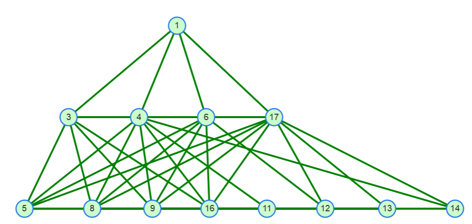

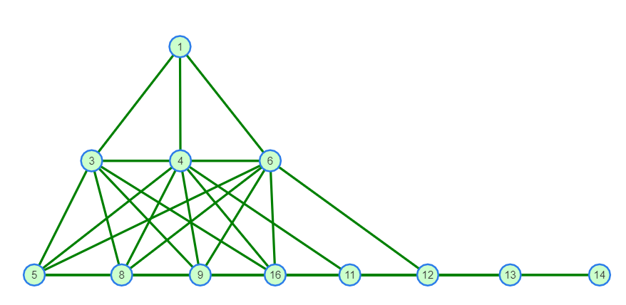

according to the neighbor list, they are not directly connected to the zwave controller but next hop to a fibaro FGRM222 rollershutter (node 4).
is there any chance to nail down the path or root cause for the intermittent delay for those devices?
How can I establish direct links between controller and nodes? should I try to move the Raspberry Pi or install a dedicated z-wave repeater?
attached the habmin z-wave network viewer
You can’t. The controller will decide the best route through the network - if the link is good directly between devices, then it will use that, but if it’s unreliable, then it will use an intermediate node as a router.
Every mains node is a “dedicated repeater”, and adding a mains socket outlet, or even a repeater (which is basically the same thing, but without the mains output!) in the “right” place should help.
In general, your network looks ok - at least for nodes 8 and 9 - both of these have 3 links toward the controller (eg node 8 links to nodes 3, 4 and 6 which all have links to the controller). Node 11 is a bit more “out there” as it only has a single link to node 4, so could be more flaky.
The network diagram is useful, but of course it doesn’t provide a physical view in relation to the your home so it’s not so easy to provide suggestions on what you can really do. I would suggest trying a mains power outlet in a strategic place to see if it helps.

thanks, after installing another FGS223 in the middle of the house (node #17) the situation improved a lot. I would not say it’s solved 100%, but the delay is happening far less
I will try to add two more zwave devices in the next weeks and check if this solves those delays completely
