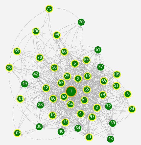

Example of one of my ZWStats (42):
The valve is currently offline which probably explains that all connections are “unidirectional” right now?(40):
Generally being marked as offline (I’m assuming the message under the node in the UI page is Node is not communicating with the controller) is when the device is has not communicated with the controller when the controller sent a message. I would have to say it is rare. Most posts in the forum seem to be about devices that are showing online but are not responding as expected (usually battery ones.)
The map is OH is a programming marvel, but is of little use for troubleshooting communication problems. With the size of your network, a zniffer is a good investment to figure out the actual paths. The only thing that seems odd is the lack of a controller. I have 46 nodes and the following map, but with the zniffer I know 34 nodes are in direct communication with the controller and no node is more than 2 hops away.

It’s funny you mention that lack of controller in the map. I have thought it odd that it doesn’t show device “1” or the controller but it has always been that way since I made this jump.
I’ll have to look into the zniffer but other than it showing me the real routes which probably don’t really matter that much in the grand scheme of things as they can change and I shouldn’t be messing with them…I’m not sure what it will do for me.

Your diagram shows all mains powered devices. That’s great because it means they can participate in routing messages, but seems unusual with all the battery devices out there. Were any powered devices misclassified, really battery) (I don’t know how, but thought I’d ask). That would mess up communications.
Bob
Thanks for your reply.
I have 1 battery powered schlage lock. Everything else is mains powered. I have been under impressed with every battery powered z-wave device I have tried driving me to alternatives.
How do I tell if it thinks it is not battery powered? I don’t see anything in the properties that seems to indicate that. It has a battery channel. Is it just the lack of yellow ring in the map? Item 41 on the right there.
Yes it is just the yellow halo, so all is good. I knew it was unlikely, but do not have any other ideas at this point.

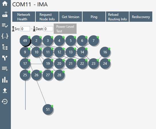

In my experience the odds strongly favor a network communication issue that could be uncovered with a Zniffer. However, the network health function of the PC controller might help. Here is an earlier version of mine (green means good communication)
