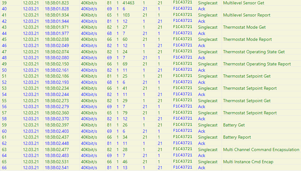

What led me to this question was this zniffer output of the poll.
I was looking to see if I could just GET the ones I’m after (Operating State Get & Thermostat Setpoint GET) and reduce the traffic. It sounds like that is not likely? A REFRESH would just send another poll. right?

I originally wrote the rules to align the operation of my two heating/cooling zones in January prior to my zniffer purchase. Several things can cause Z-wave controller cancelled frames, but pre-zniffer, that is what I used to judge if Z-wave frame traffic was excessive. A three minute poll of each Node thing did not seem to cause any problems. With the zniffer I saw all the traffic (most extraneous) and asked the posting title question to see I could just get the one item I needed. Again I appreciate all the replies.
For now, not wanting “perfection to be the enemy of the good”, I have implemented the “Refresh” idea that I marked as the solution, triggering on temperature changes and set polling back to 86400. This has reduced traffic at least 60% from my earlier, and non-problematic working set-up. A step forward in my book.
As to the RTC101 devices, while working on the “Refresh”, with the polling off and using the Zniffer, I noticed that the device does send reports on the operating state (i.e. Heating On). The frequent polling of the original solution apparently suppressed these reports. I ran this way for several hours and captured the frames. The problem was that the device report for operating state (key item in my logic) was not reliable. Sometimes the report was when heating started (good), but sometimes it was several minutes later. Likewise the report for heating “stopped” did not match with the furnace, so I moved the “Refresh” rule back into the model and called it a day.

Yes. Based the Zniffer it appears the device waits until a temperature report is required by the configuration. If the Heat message is not included with the temperature change (the 20 year old furnace warm-up could be a factor) it waits until the next temperature change to send the Heat On, after the heat on is well underway (or heat OFF after it has been off for several minutes). The Heat message ON or OFF was typically delayed 7 minutes+ until the temperature changed again.
