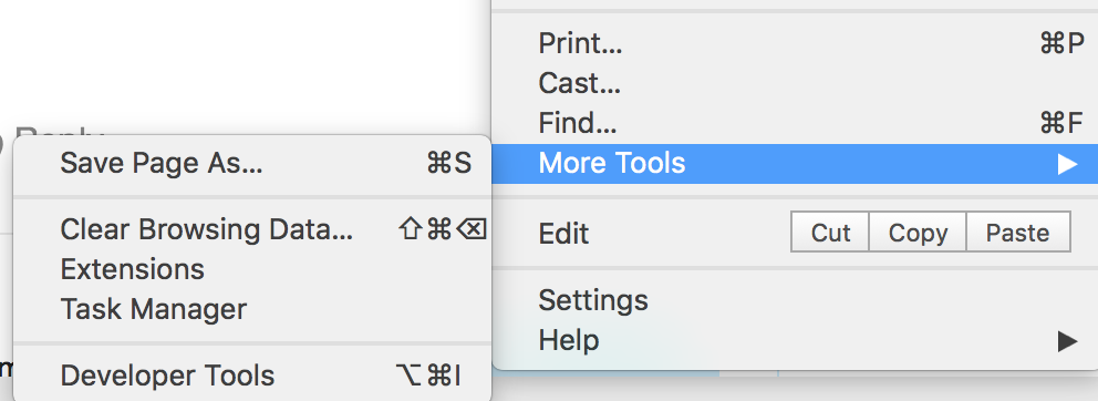

One thing to take a look at - can you open the browser debugger- if you have Chrome - it’s here (Developer Tools) -:
Then send the action, and take a look at what errors are reported on the CONSOLE tab, and also look in the NETWORK tab - you should be able to find the transaction, click on this and view the data that HABmin sent - it would be good if you can copy that here.
