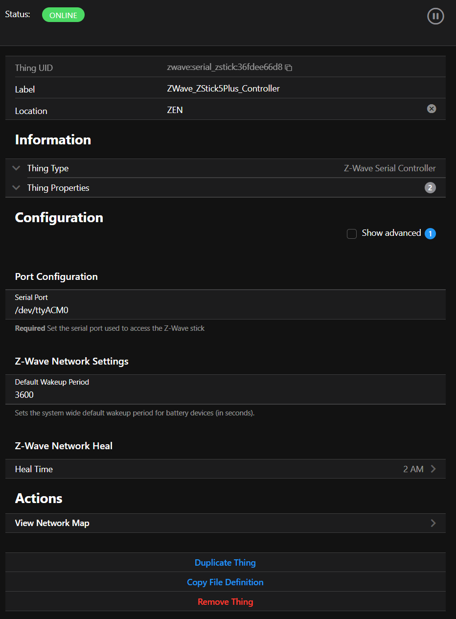

this is the first time now that I want to exclude a Z-Wave device from my controller after upgrading to openHAB 5.x. I am on openHAB 5.1 currently and we are talking about the old Z-Wave binding. There is just no Z-Wave specific buttons available in the thing page of my controller:
Any ideas what to do? Can I remove and recreate the thing without loosing any configuration?
Are you on 5.1 or 5.1.1? 5.1.1 included a fix for some missing Zwave actions - maybe that would solve your issue? If you are already on 5.1.1, ignore this…
I am on 5.1.0. It is working after the update. Thank you for the hint.

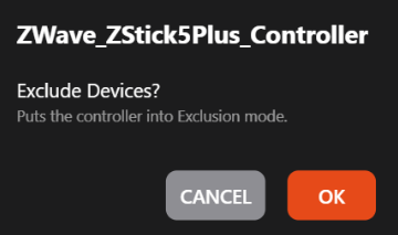

Can you please check if there is a toast notification and what it displayes when executing an exclude action?
There is a popup:
If I press OK nothing happens in the UI and the first message in the log is:
2026-01-26 19:16:40.595 [INFO ] [ab.event.ThingStatusInfoChangedEvent] - Thing 'zwave:serial_zstick:36fdee66d8' changed from ONLINE to OFFLINE (COMMUNICATION_ERROR): Controller is offline
Do you want me to test with ZWave debug level?
What is currently happening when you try any of the Zwave action items is that the controller is reset and nothing else will happen. If you look at the code tab, you will see exclude = true, but that is not how it is supposed to work. @florian-h05 has a fix, but it is not merged. I would try Simplicity Studio.
