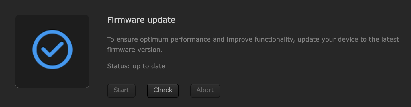

Looking at it right now I have two dead plugs in that installation also. Looking at it from remote all currently working plugs are on 3.2 so I will definitely try to upgrade. Sounds like a tedious job to remove all plugs from OH, add them to HC2, upgrade firmware, remove them from HC2 and finally add them to OH again…
Skärmavbild 2021-09-19 kl. 19.27.18
Crap - 3.2 is the latest…
