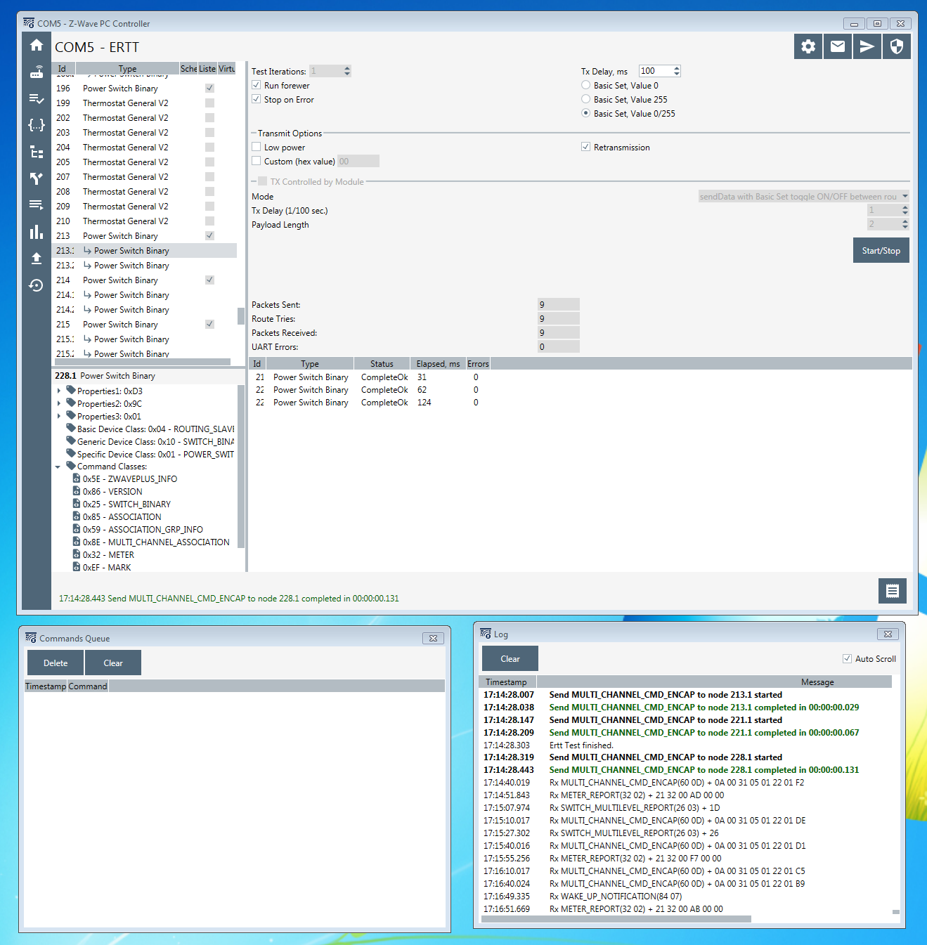

First test 3 devices all binary switches z-wave plus.
the first is a direct route the second 1 hop the third 3 hop. You can see the increase in response time.
The test looks like this

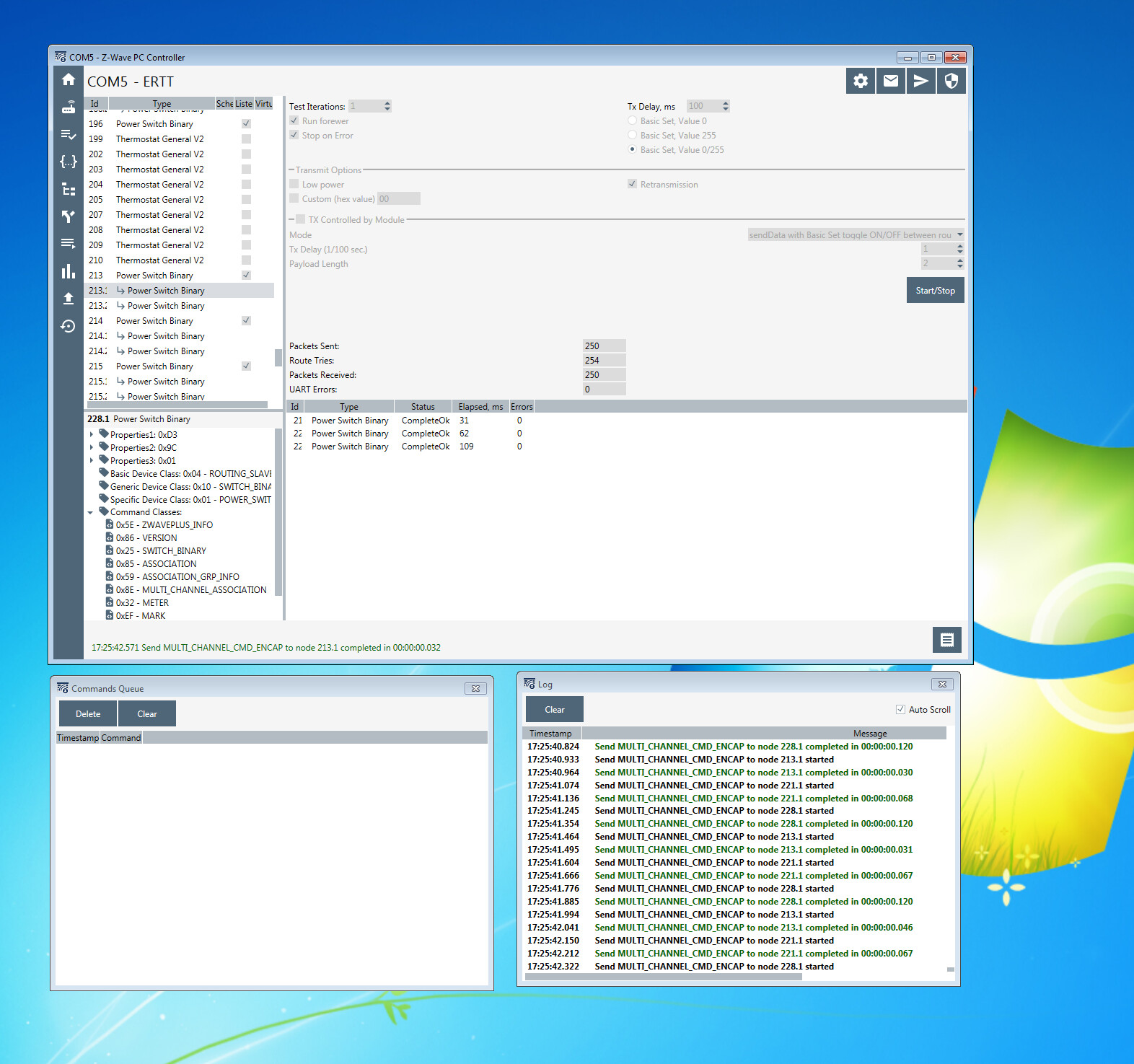

The delay between commands is set to 100ms so not pushing.
here it goes and it is looking fine

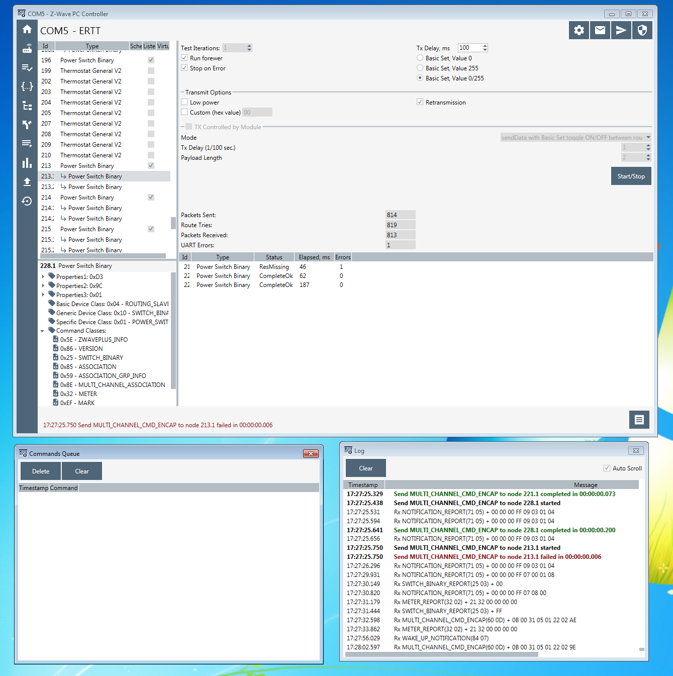

but I trigger a load of reports and
I blow the UART

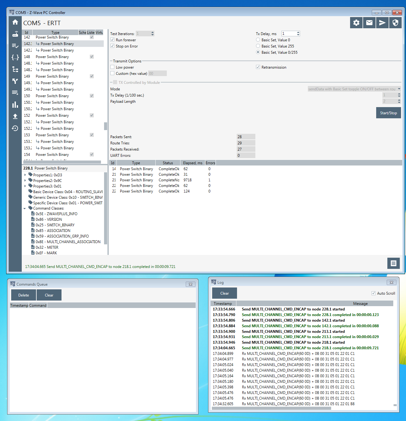

and then with 5 and only 1ms so pumping those commands as soon as one do the next
trigger a load of reports to arrive and again I make it fail but this time one of the commands times out and never gets a response.
Clearly neither of these are routing issues. All routes are good but when traffic increases above a certain point, particularly with lots of unsolicited traffic things break.
