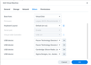

What works very well for me is running openHAB on a VM using Virtual Machine Manager. DSM passes the USB devices through that can be “attached” to the (QEMU) VM. I use a minimal Debian Bookworm on top of which I install openHABian. This has the advantage that you can “unplug” the Z-Wave dongle and "attach is to Windows VM for example to run Z-Wave PC Controller to update OTA firmware or remove dead nodes without having to physically touch anything.
Above you can see my attached DSMR, RFXCom, Bluetooth and Z-Wave dongles.
Additionally you have all advantages of taking snapshots prior to updates or changes and you can backup the entire VM to deploy it on another device. I have allocated 2 CPU’s and 4GB of which half is used on my RS1221+ with 32GB and CPU usage is below 3%.
