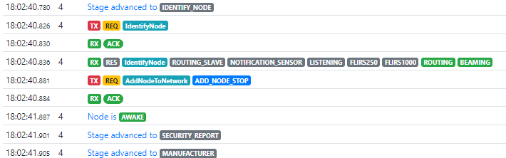

I’m trying to pair a Heiman smoke detector HS1SA-Z to my Openhabian system (with an Aeotech z-stick gen 5). The stick finds the smoke detector, but the interrogation seems to fail. I get no xml-file in the zwave folder and the device is not recognized.
The Z-wave log-file looks like this:
and down the bottom I get one line with:
“RX REQ AddNodeToNetwork ADD_NODE_STATUS_DONE NODE 15”
It seems the Request for NIF never finishes. As you can see in the log I tried to wake up the device several times by pressing the test-button (get some beeping but the device wakes up and sends an alarm report and a sensor binary report). But no NIF?
What am I doing wrong?
