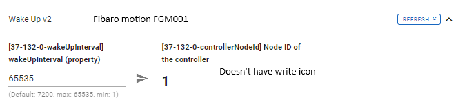

I am slowly migrating from the zwave binding to zwave js.
I can’t get rid of the following warning message in the logs:
2025-12-06 15:20:58.827 [WARN ] [ab.binding.zwavejs.internal.api.ZWaveJSClient] - Received ResultMessage type: result, success: false, status: null, error_code: zwave_error, message: Invalid ValueID passed! (ZW0322)
I started troubleshooting with removing and readding one Thing after another in trace logging mode and found:
2025-12-06 16:55:20.734 [DEBUG] [ab.binding.zwavejs.internal.api.ZWaveJSClient] - SEND | {"nodeId":3,"valueId":{"commandClass":132,"endpoint":0},"value":1,"command":"node.set_value"}
2025-12-06 16:55:20.755 [DEBUG] [ab.binding.zwavejs.internal.api.ZWaveJSClient] - Sending command: NodeSetValueCommand.
2025-12-06 16:55:20.757 [WARN ] [ab.binding.zwavejs.internal.api.ZWaveJSClient] - Received ResultMessage type: result, success: false, status: null, error_code: zwave_error, message: Invalid ValueID passed! (ZW0322)
2025-12-06 16:55:20.842 [DEBUG] [zwavejs.internal.handler.ZwaveJSBridgeHandler] - ResultMessage missing result or state, ignoring.

I have the device but have stuck with the generic mqtt option. What it look like to me is that it is trying to set the wake-up node to the controller and it is read only. (Correctly so because it seems to be populated elsewhere). Don’t know why this device is the only one.
I based this on this in your log before it tries to set it; 2025-12-06 16:55:19.114 [TRACE] [wavejs.internal.type.ZwaveJSTypeGeneratorImpl] - >> ChannelMetadata [nodeId=3, Id=wake-up-controller-node-id, label=Node ID Of The Controller, description=null, unitSymbol=null, value=1, itemType=Number, writable=false, readProperty=controllerNodeId, writeProperty=null, state=1, statePattern=StateDescription [minimum=null, maximum=null, step=null, pattern=%d, readOnly=true, channelStateOptions=], commandClassName=Wake Up, commandClassId=132, endpoint=0]
I suspect it can be ignored if your wake-up class in zui looks ok.
Thank you very much for looking into this.
Wake up for that node in Zwave-JS UI looks good.
Meanwhile I found out that my conclusion for node 3 was just a coincidence.

  3. In the log, there’re other warning like in the attached trace log:
    /var/log/openhab/openhab.log:2026-03-16 20:07:07.111 [WARN ] [ejs.internal.conversion.BaseMetadata] - Node 3, unexpected value type: null, please file a bug report
    /var/log/openhab/openhab.log:2026-03-16 20:07:07.455 [WARN ] [ejs.internal.conversion.BaseMetadata] - Node 4, unexpected value type: null, please file a bug report
I shared the tracelog during the bridge reconnecting here. full trace log after disable and re-enable the bridge.
For now I can workaround above issue, but I do appreciate some enlighten here so I can be sure I’m on the right path.
  1. Yes, the channel is read/write and therefor has the label as you see it. Suggestions are welcome, currently it picks the read-only label.
  2. This can be fixed, with the provided node json details, i can create a simple fix.
  3. Not sure how this behaves, but with the above json node data i can reproduce it easily.
    Give me a moment to come up with a jar to test
