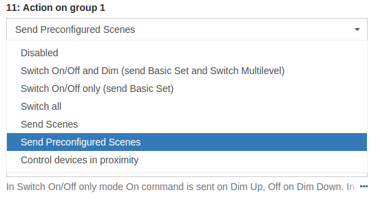

I am trying to get a Z-Wave.Me KFOB-S (Type:ID 0100:0103) running in an openHAB 2 installation. The KFOB-S is detected just fine and I can reach the Thing configuration settings just fine in PaperUI as well as in HABmin. I would like to configure the “Action on group 1” according to KFOB-S User Manual. There should be a “Central Scene to Gateway” for the “Action on group 1” parameter. But I cannot see nor select it; neither in PaperUI nor in HABmin.
Any hints? Ideas how to get the KFOB working with a non-“Central Scene to Gateway” action on group are welcome as well.

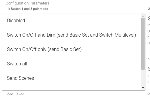

These two pictures show the options I have in PaperUI. “Control DoorLock” and “Central Scene to Gateway” are missing.
This picture shows that it is a KFOB-S 0100:0103
This picture shows the same missing options in the HABmin interface.

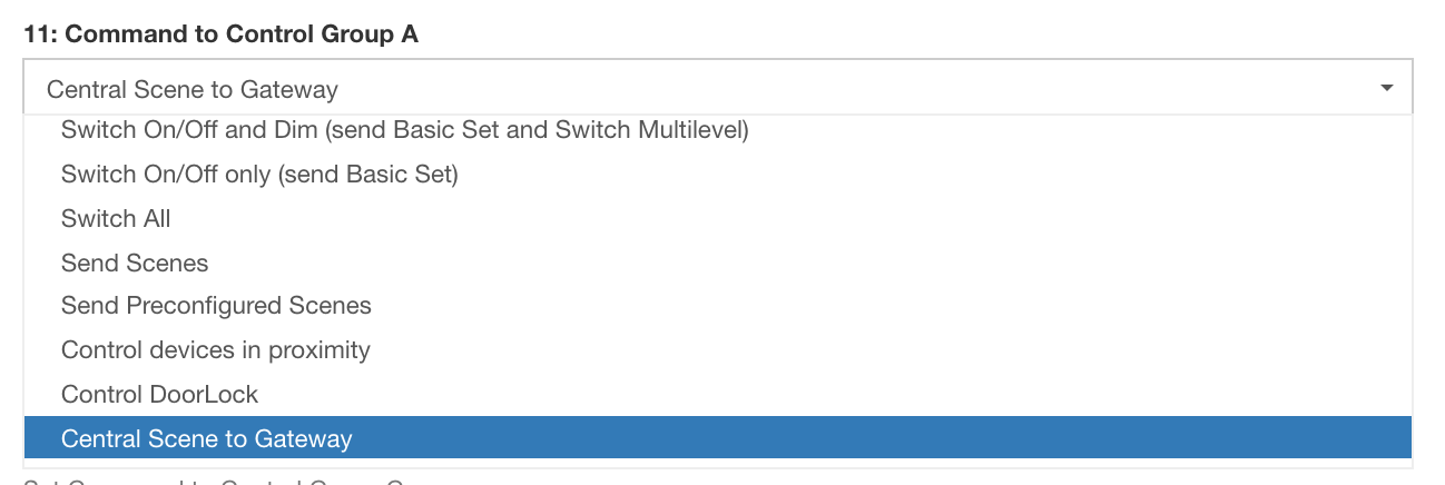

I can’t see any reason why this would be missing. It’s certainly defined ok in the database and I don’t see why the framework would choose to ignore it.
I just added a thing of this type into my system and I see this configuration fine -:
It won’t - it’s nothing at all to do with the controller, or the device - just the database. Maybe the version you have has a problem with the database, alhtough from what I can tell in the history, there’s only been one version of this device.
Really stupid question, but you did scroll down through the options ;). I would also maybe try another browser just in case that’s the problem…
I found the reason - It looks like your device is detected as a KFOB, not a KFOB-S. If you update to a more recent binding it should work as the IDs were updated 2 months ago to resolve this.
