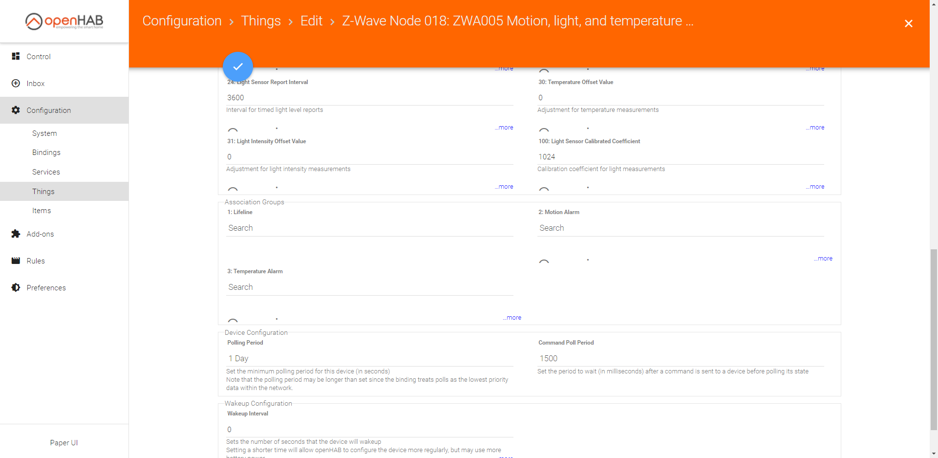

Now, I’ve jet discouvert my thing 3 times… but it seems the problem is that the created thing in my Paper UI doesn’t have any “Lifeline” associeted group.
I’m not an expert but I think that in this case my sensor will not communicate with my controller.
So… I tried to add the lifeline with the controller with no result…
I’ve tried yet with Paper UI and Habmin… same result… what i’m missing?

I re-discoverd my sensor another time. Now after pressing the action button for 5 sec on the trisensor and waking up all the system I can change some of the caracteristic (sensibility, illuminance, …) but no way to give the lifeline value…
can I try from another way?
and the log say:
2020-12-13 10:49:35.564 [me.event.ThingUpdatedEvent] - Thing ‘zwave:device:0b045602:node22’ has been updated.
Blockquote 2020-12-13 10:49:35.567 [vent.ConfigStatusInfoEvent] - ConfigStatusInfo [configStatusMessages=[ConfigStatusMessage [parameterName=config_1_2, type=PENDING, messageKey=null, arguments=null, message=null, statusCode=null], ConfigStatusMessage [parameterName=config_2_2, type=PENDING, messageKey=null, arguments=null, message=null, statusCode=null], ConfigStatusMessage [parameterName=config_3_1, type=PENDING, messageKey=null, arguments=null, message=null, statusCode=null]]]
