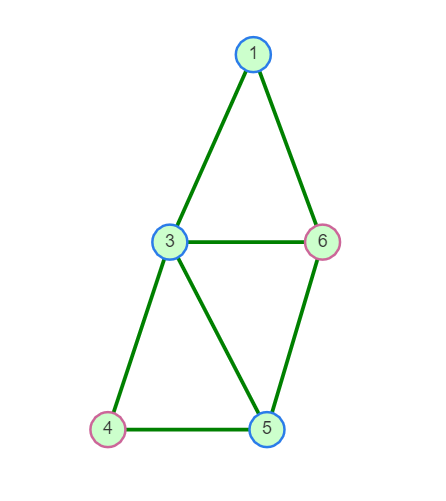

It looks that all devices were included ok. I can control relay and dimmer and also I’m receiving notification from battery sensors. Then I moved sensors far from the main controler but they still should be in node3 range. But now, I don’t receive any notifications from battery powered sensors. It’s more than one day and according to last update, at least node4 should be in range, because there are update for last heal and wake up times.
But, I’m not receiving any notifications from this sensors.

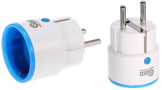

Just an idea: Can you place a Z-Wave plug near the sensors? A cheap one like this:
They are around 25€ here, and they would act as repeater down where the sensors are.

I already tried network heal, but without any change. Strange thing is, that nodes 4 and 6 looks like online, and node 6 is connected straight to main controller, what is basicaly not true.

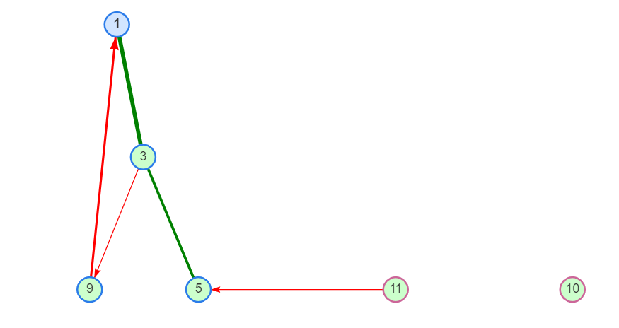

I bought Aeotec ZWA001 Bulb 6 Multi-White (node9) I’m not able to control it in cellar.
I tried to include it when it was in cellar, but without success. Then I tried to include it near the controler and it worked fine. After moving back to cellar, it looks like connected in Habmin, but I cannot control it. (also after few Network sync/Device heal).

Funny is, that node10 on last picture is battery powered door sensor, and was included from cellar. Was included but doesn’t respond now.
