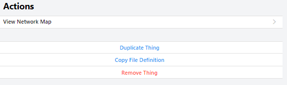

Hello I changed to a new PI5, fresh installation of openhabian and then restored the ZIP backup.
Everything is working but the z-wave network map is empty. and also some actions are missing.

Just rested and I can unfortunately confirm, the Z-Wave map is no more rendered.

Is this a bug or by design? Also the missing Actions like âsynchronize networkâ?

What were the actions available in the past ?
The only action I am seeing is âView Network Mapâ and it does not work ?
I am searching a way to remove some Z-Wave devices from my network. Wasnât there actions for inclusion and exclusion in the past ?

Quick look. It appears that the ACTIONs are not populated for either the controller or devices. The has been no change to the binding (except for ZW DB updates) that I can see. Possibly the new UI vue is not picking them up. I do see the underlying configs in the API explorer that would trigger the actions. Typical device actions (old)
Now

I just created an issue for the missing actions.
opened 12:39PM - 27 Dec 25 UTC
bug
main ui
When opening the thing page of the Z-Wave controller thing in OH 5.0.3, we can a⊠ll these actions:
<img width="1488" height="804" alt="Image" src="https://github.com/user-attachments/assets/7cfa2c06-1648-4691-b4c0-53645277cca1" />
In OH 5.1, they all disappeared:
<img width="1490" height="374" alt="Image" src="https://github.com/user-attachments/assets/7d0d9a54-1a74-48f9-96e5-446bd62c3626" />
Regarding the network map, I can confirm that it works well in 5.0.3 but is broken in 5.1.

A fix was merged today.
Will be included in next 5.2 snapshot and of course in next 5.1 patch.
main â digitaldan:mainui-z-wave-fix
opened 03:24PM - 27 Dec 25 UTC
Edit: already available in snapshot 5049. Tested and working.

It seems with 5.1.2 it is broken again. Map remains empty. I also had to reinstall after upgrade from 5.1.1, installation was broken. But heal time 2am is passed with new install and still the map is empty.

Upgraded to 5.2 M1 and map is working again.
