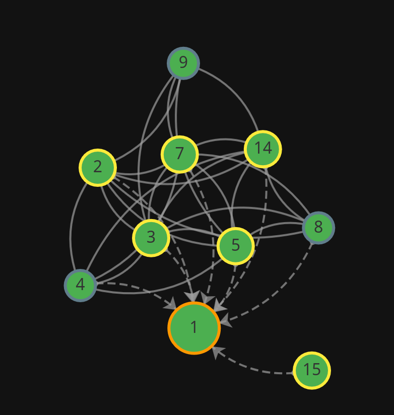

Few weeks ago, I unplugged/disconnected a Fibaro dimmer device that was in my wall. I am very surprised to see that several weeks later my thing still appears as ONLINE in openHAB and this node is still present in the map (node 15):
I had in mind that there was, at least in the past, an automatic network health check run every night. Is it a feature that was removed ? If not, I would have expected my node being detected as not reachable and probably rejected from the network after a certain time ?

But my node 15 now no more appears in the middle of the mesh network but rather just connected to the controller. So maybe the mesh network was automatically properly adjusted and this node will not disturb the full mesh network. I am just asking myself why it is still in the network while the physical device does no more exist.

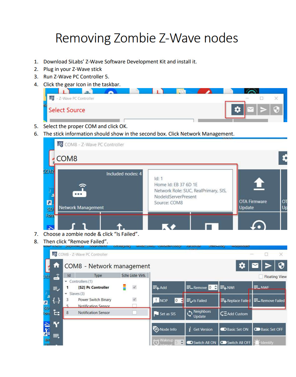

If you just remove the node before actively unpairing it first , you end up with a Zombie node. Often introduces 5s retransmission delays.
The procedure of using PC tool SW as described repeatedly. Search for Zombie nodes.

As to the online device, that should go offline with a restart, but probably not just over time. Might depend on the poll parameter.
The network picture is not diagnostic, it shows neighbors, not routing. There could be problems when a powered node is not online. Should be removed with Simplicity studio as noted by @OMR

Regarding Simplicity Studio 6, the software was not able to detect my USB Aeotec Stick on Linux Mint. Will try to install it on Windows 10.
It is in the way the UI is handling the parameter group actions of the ZW binding (and possibly others). IMO The right person is aware of the problem, but for now use Simplicity to remove.
Not better on Windows!
Is there something special to do to discover USB stick connected to the PC ?
Or should I rather test Simplicity Studio 5?
Do you see the stick in the Device Controller?
It will show you the COMX number to choose:
I fired up my old Surface 4 Pro and checked. I have indeed used v5. No experience with v6.
I actually have studio 5 also working with Windows 11. I’m pretty sure I used it on my Aeotec Gen5 before I flashed upgraded firmware. It is probably not urgent unless you are seeing other problematic behavior and can wait until the UI fix.
