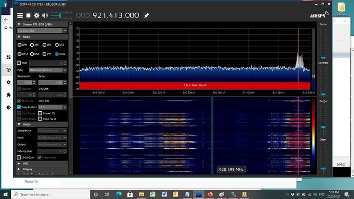

Every bone in my body is screaming RFI (Radio Frequency Interference).
The way I see it, if nothing changed in the system, it must be from an outside influence.
I have included a Airspy Spectrum Analyzer screen shot taken in the range of Z-Wave Frequencies used here in New Zealand.
You can see the Z-Wave signals (919.8MHz and 921.4MHz), and the noise floor at around -50dB.
The first screenshot is taken near the controller, the second, near one of the nodes.
Any ideas
Surely Z-Wave has better range than this?

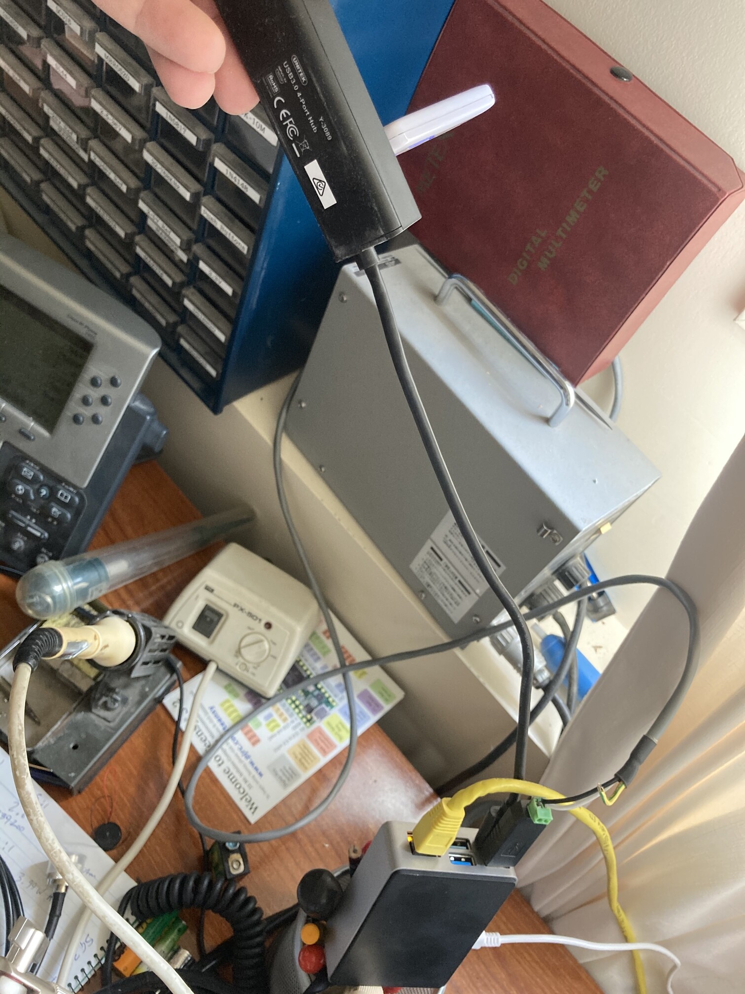

Have you tried your stick on a USB cable, to get it away from the Pi?

To answer the Dalek, e-x-t-e-r-m-i-n-a-t-e ! seriously though the z-stick is 30cm away from the pi on a usb hub. Let me know if you think it will work better at a greater distance. No external power supply though - as it doesn’t make any difference to the result when I connect a power supply. I heard the pi has inadequate capacitors on the usb power supply which is why the z-stick doesn’t always get detected when plugged directly into the pi usb port. Big lesson learned there.

I hesitate to mention this, but try the z-stick on the USB hub with only an SD card running openhab2 in the pi (nothing else on the usb ports. I see you have something else attached. I have had trouble with an SSD attached to Rpi4.
Bob
Seems reasonable.
(EXTERMINATE! must always be written all caps, with at least one exclamation mark. It’s the law. You can add hyphens though.)
The other device you can see in the photo is a Modbus RS485 usb dongle which gathers realtime power usage data from a check meter in my switchboard.
The wired Modbus is the one part of this home automation system that works 100% reliably.
I already tried removing the RS485 dongle but it did not help to resolve the ZWave comms issues.
I will attempt a longer USB cable and remove the RS485 dongle again as a test.
