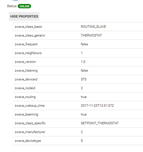

I was trying different things (removing the things and adding them again).

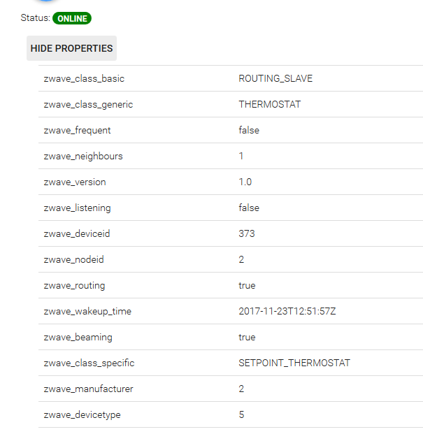

The I discovered when I was looking in the property section of the things, that they are all just connected to neighbor 1 (which is the z wave controller)
I think this ins’t the way this should work? I’m confussed at the moment. How could i force the network to connect to other neighbors? I think this will solve the problem with the devices which are not near controller and have problems to connect.

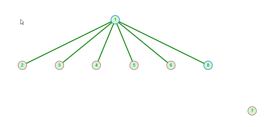

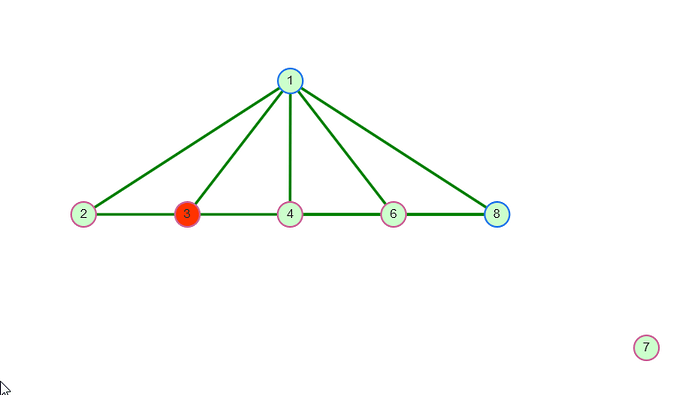

Thats how my Zwave network looks at the moment:
Well, that looks kinda sad, especially node 7 :slight_smile:
There is a developement version of the Z-wave binding which works much better than the default one for many users (including me), I think you should try that instead. See this thread for more info.

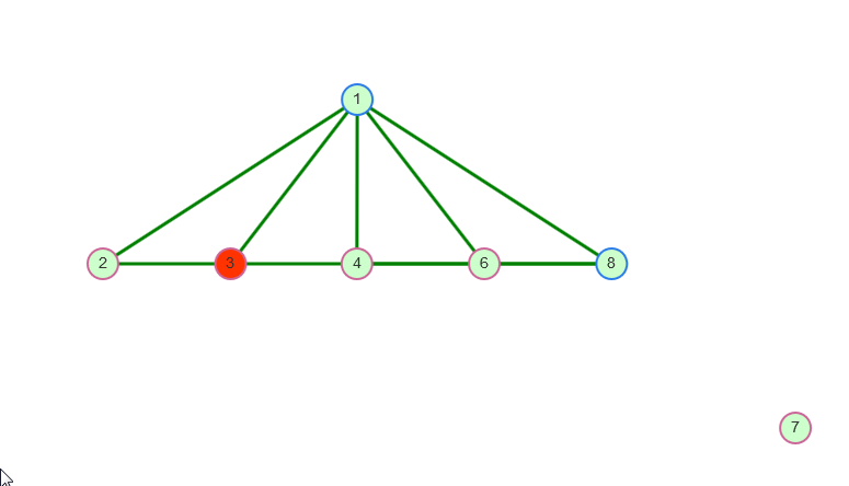

Now it looks better than before, but there are still problems with node 3 and 7
Sorry, I forgot to mention that.
Node 7 is a battery-powered device (the red circle), so it might be that it hasn’t woken up yet. You could try waking it up manually to see if it changes.
I’m not sure what the solid red circle means. Is node 3 battery-powered or mains?
Yes, they are all battery powered devices (except node 8)
I tried to woke up them several times and switched them off by taking the batteries out and switched them on again.
But this doesn’t solved the problem.
The solid red means the controller is reporting it as dead, which can be a temporary state. A wakeup should help, but they will also wakeup on their own, so you could just check back in a few hours (Habmin will show you the devices wakeup interval). Are you sure you’ve woken node 3 up properly? It might just be out of range of node 1 and 8. Powering them up again will usually send an NIF, but not perform a wakeup. I’ve also seen somewhat significant range reduction with low batteries, so you might want to try some fresh ones.What device is Node 7? My Aeon Minimotes show up as orphans like this, which is expected.
One thing I’ve learned is that Z-Wave often requires patience. Sometimes whatever I do there are nodes who completely refuse to talk to rest of the mesh network and I give up and then suddenly a couple of hours (or days) later everything is working like a charm.
Also note that this binding does a network heal every night (default two oclock), so things often look better in the next day because of this.

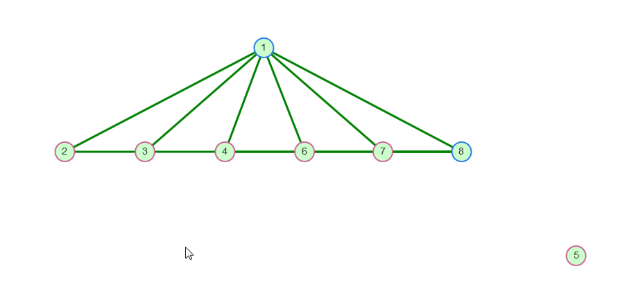

But i have still Problems with node 5. It is a battery device but i placed it not more than 1 meter from node 8 which is not a battery device.
So my expectation was that node 5 connects to node 8 if it can’t reach node1.
It depends on their capabilities. What are node 5 and 8? What do the logs have for node 5, especially after a wakeup?
