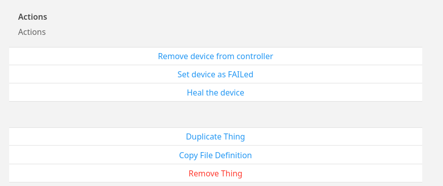

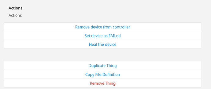

An explanation of all of these options really belong in the Z-Wave binding documentation IMO. I’ve seen questions like this come up before.
I’d extend this request to these other options shown here too.
e.g.
What happens when I set a device as FAILed.
What exactly does it mean to remove the thing? From what? From the config only? Remove from both the config and the controller? Do I need to first enter exclusion mode somehow?
Why does this option do nothing when the device is unreachable?
