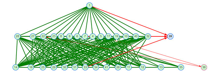

So the weird thing is this zwave lock is in the middle of my house, the same as my controller, and there are MANY devices a lot further than the lock is, as you can see the mesh look pretty healthy, except for the lock (node39), and node36, which is a multisensor outside in my shed. Do you know what the red lines mean? .
It means that there is only one way communications with that device. This may or may not be correct - it could also mean that the device hasn’t reported its neighbours, but it likely is indicative of communications issues either way.
