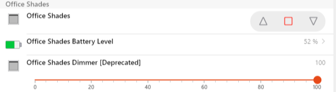

After clicking the Office Shades up button
The shades are fully opened and report as closed

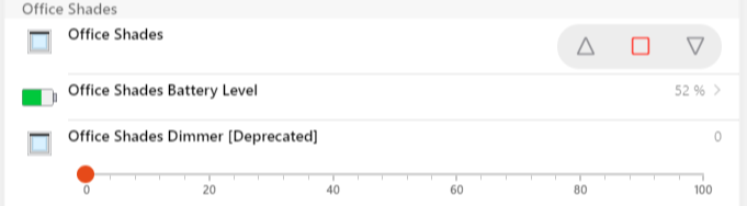

After clicking the down
The shades are fully closed and report as open

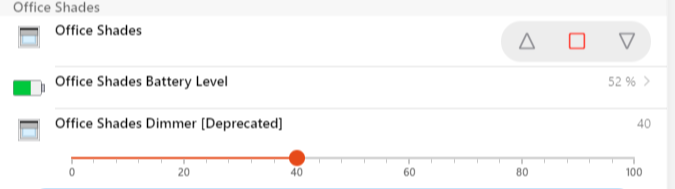

Setting the “deprecated dimmer” to 40
The shades are half open and report as such.
Any suggestions as to why?

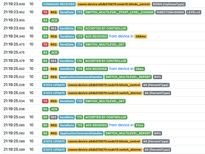

Not really. A list of item state changes doesn’t really provide any information about why the state changed - it just logs the changes. If this is a zwave device (which I’m also unclear about) then debug logs from the zwave binding might help.
Yes… it is a zwave device
Debug logs
events.log (73.1 KB)
openhab.log (80.9 KB)

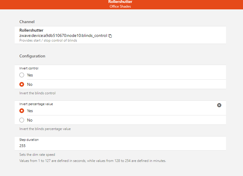

There are two configurations on the blind_control channel - one that will invert the control, and one that will invert the status. You should be able to use these to configure your system.
Looking at the log, I don’t see any issue - the binding correctly reflects the status reported by the device and I don’t see any random values reported like you showed in your first post.
–deleted
Found it
That did it.
