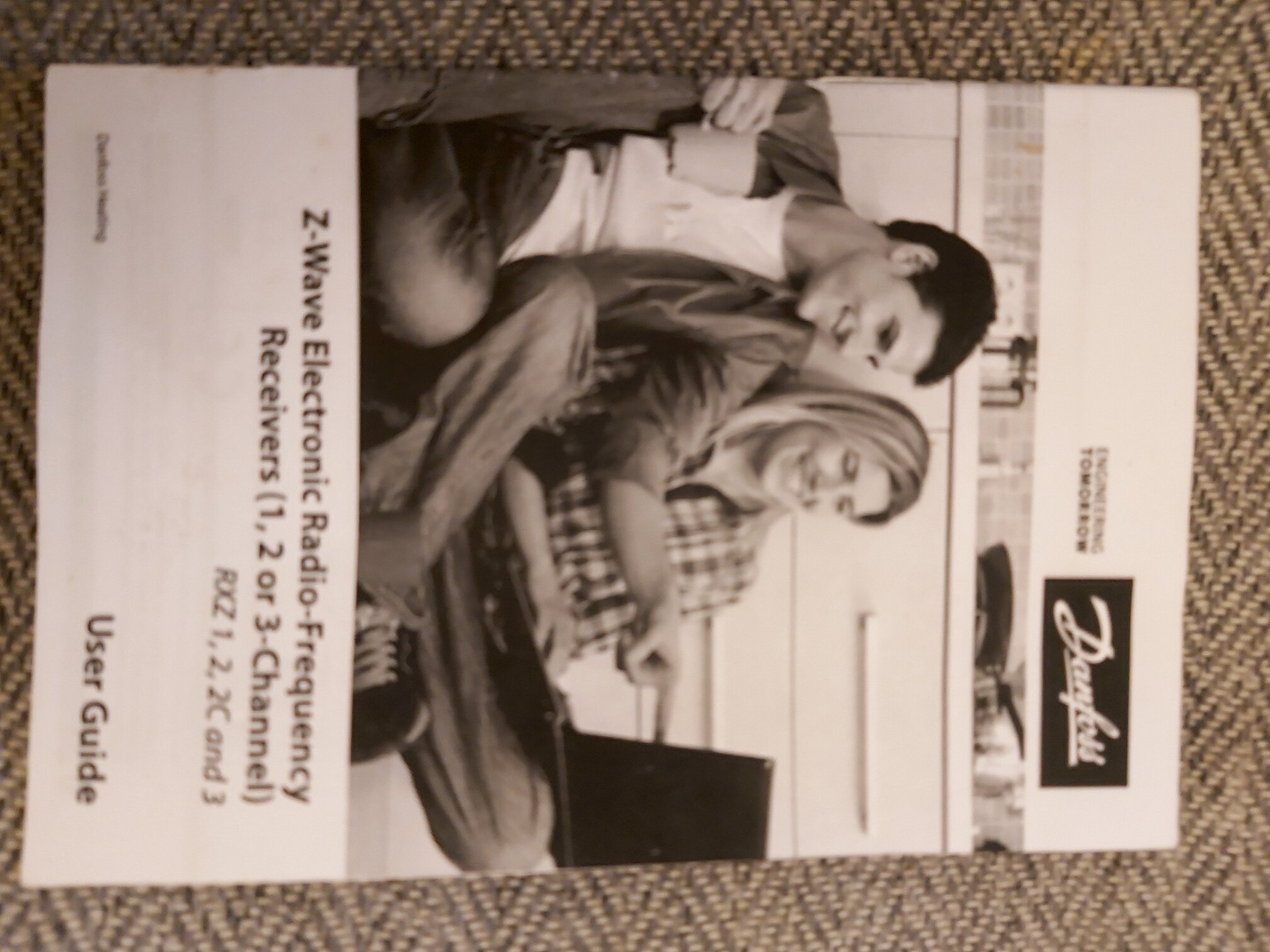

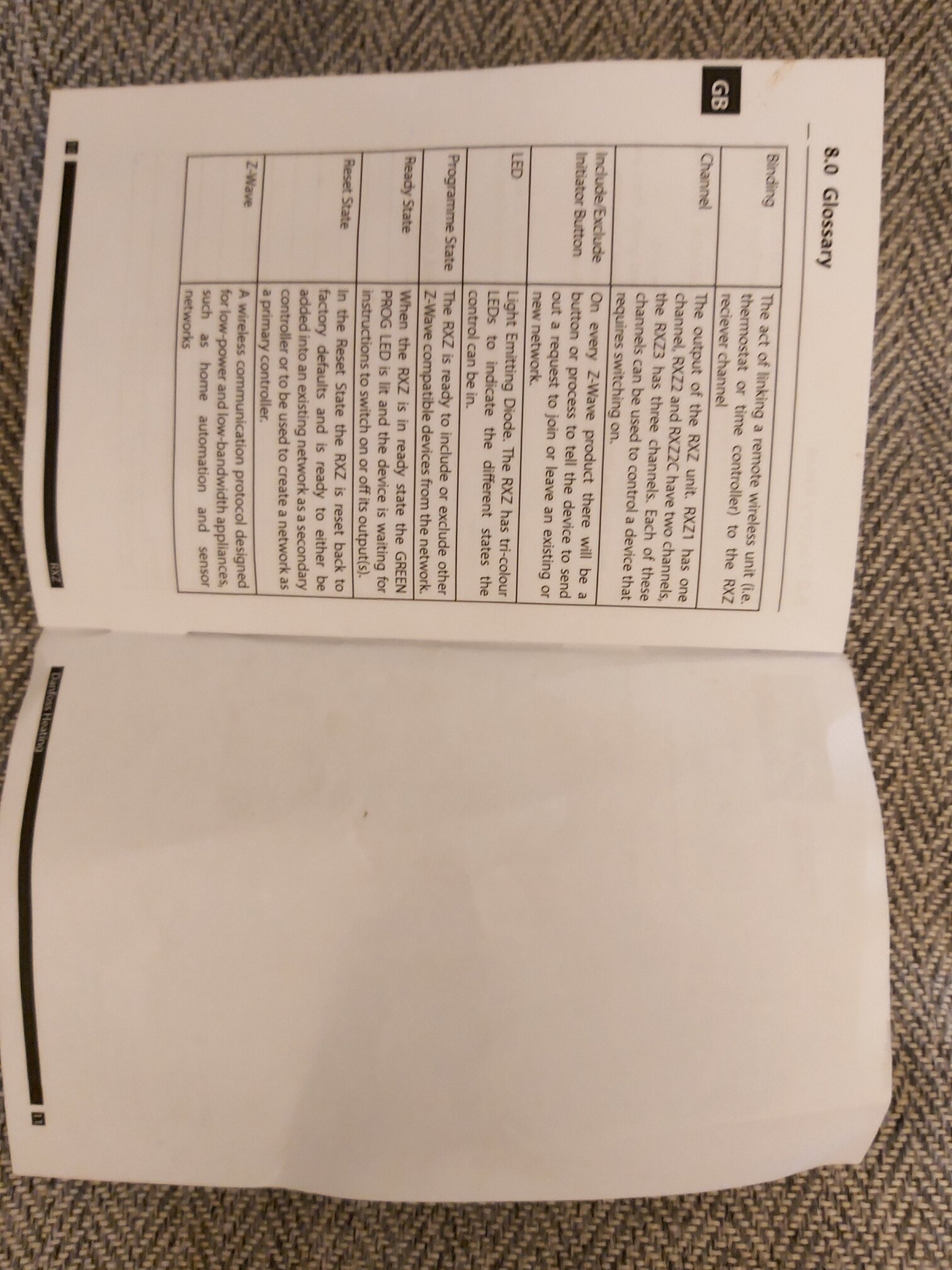

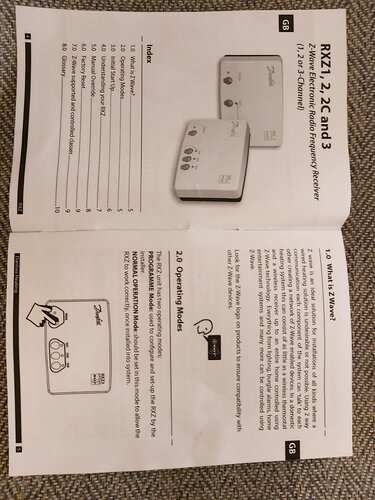

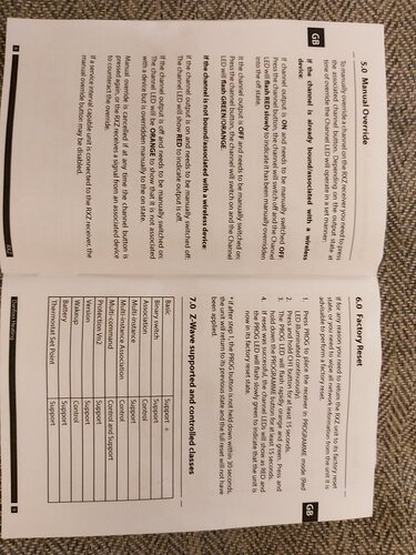

I havw twice tried to upload these as files but the system is uploading inline images and not in the order I selected them ???
Any good?

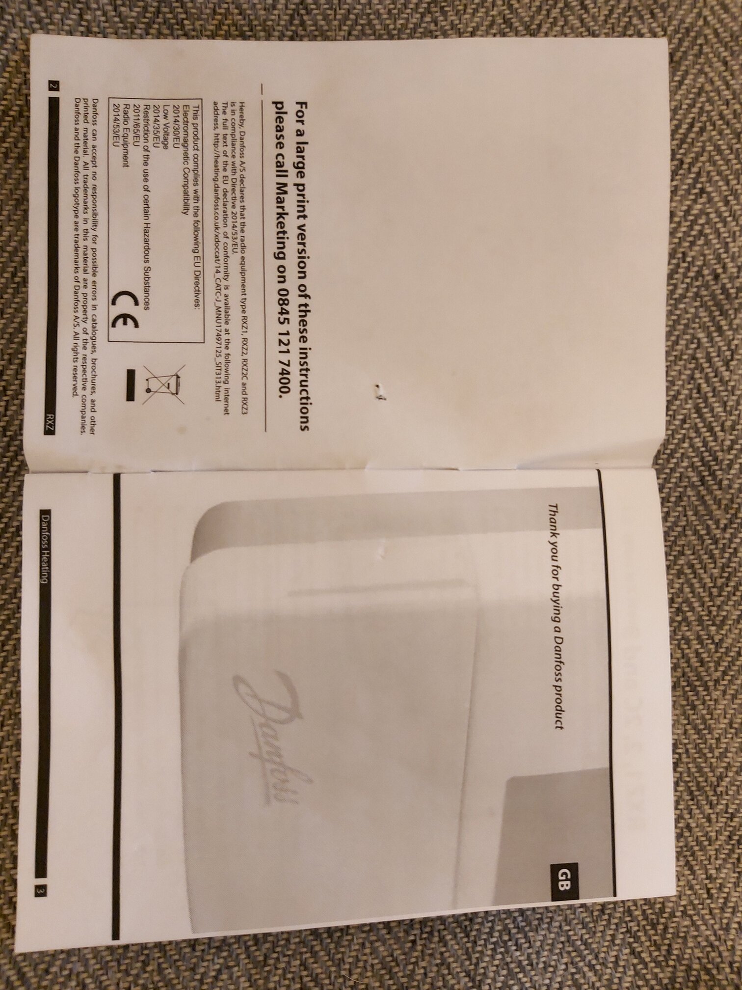

Understood, I couldnt run it through at the time , then went to bed, and when I awoke it seems the entry had been raised with more info from me needed. Hope the manual is good enough?
It looks readable but, unfortunately not much information for configuring, I will try to make a ldf manual from it and enter what information I can.
Thank you again. Sorry for the stress at home. We have all experienced similar situations.
