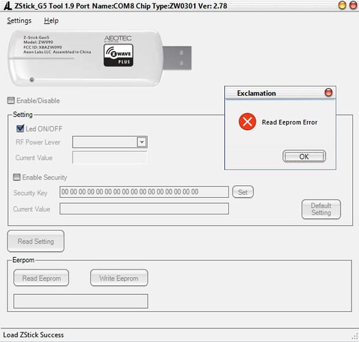

@chris669 I am trying to migrate from a S2 to S5 stick myself, but when I do a “Read Eeprom” on the S2 stick, it always fails with “Read Eeprom Error”.
You are referring to the backup software from Aeotec, right?
