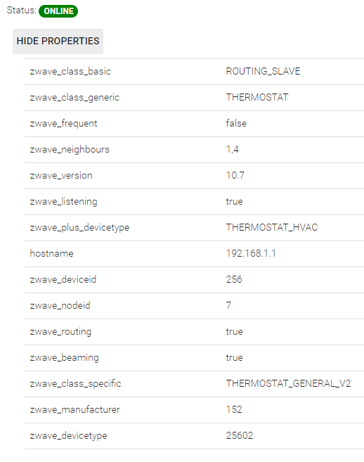

What does HABmin or PaperUI show? What is showing in the device properties/attributes?

Capture
Capture
Thanks.
It looks fine - I would just make sure that you are running the absolute latest version and it should work ok.
I think I have it working now. I verified multiple times that I was running the latest snapshot, but for some reason it still wasn’t updating the local database. The only thing I could think of is that I have been doing all the updating through the openhabian configuration utility. Last night I decided to try updating the addons through command line using Openhab’s instructions. Once it completed, all the channels magically appeared for that thermostat. I guess just because everything says you are on the latest build doesn’t necessarily mean that you are. I hope this helps anyone running Openhab on Openhabian. Thanks Chris.
