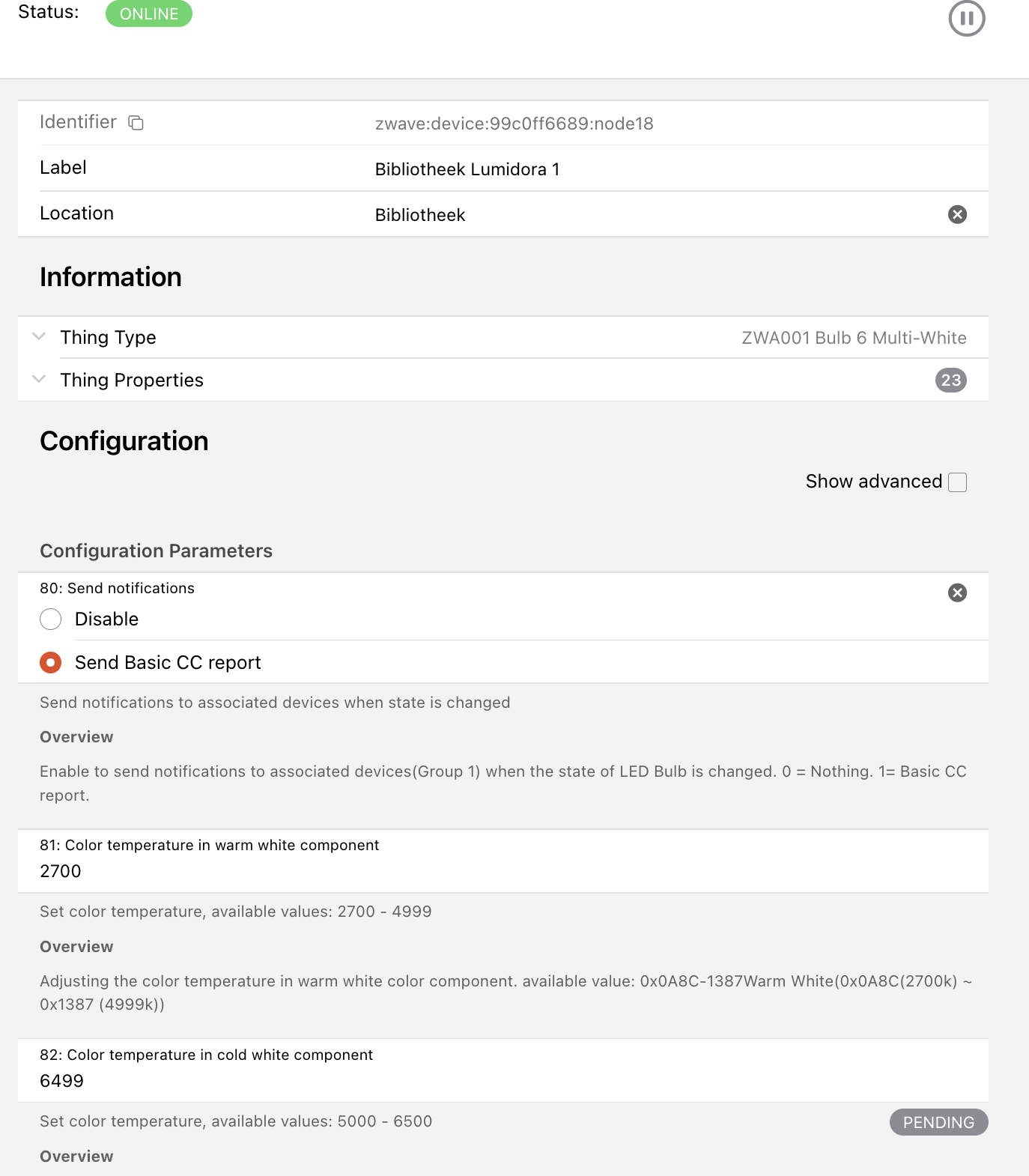

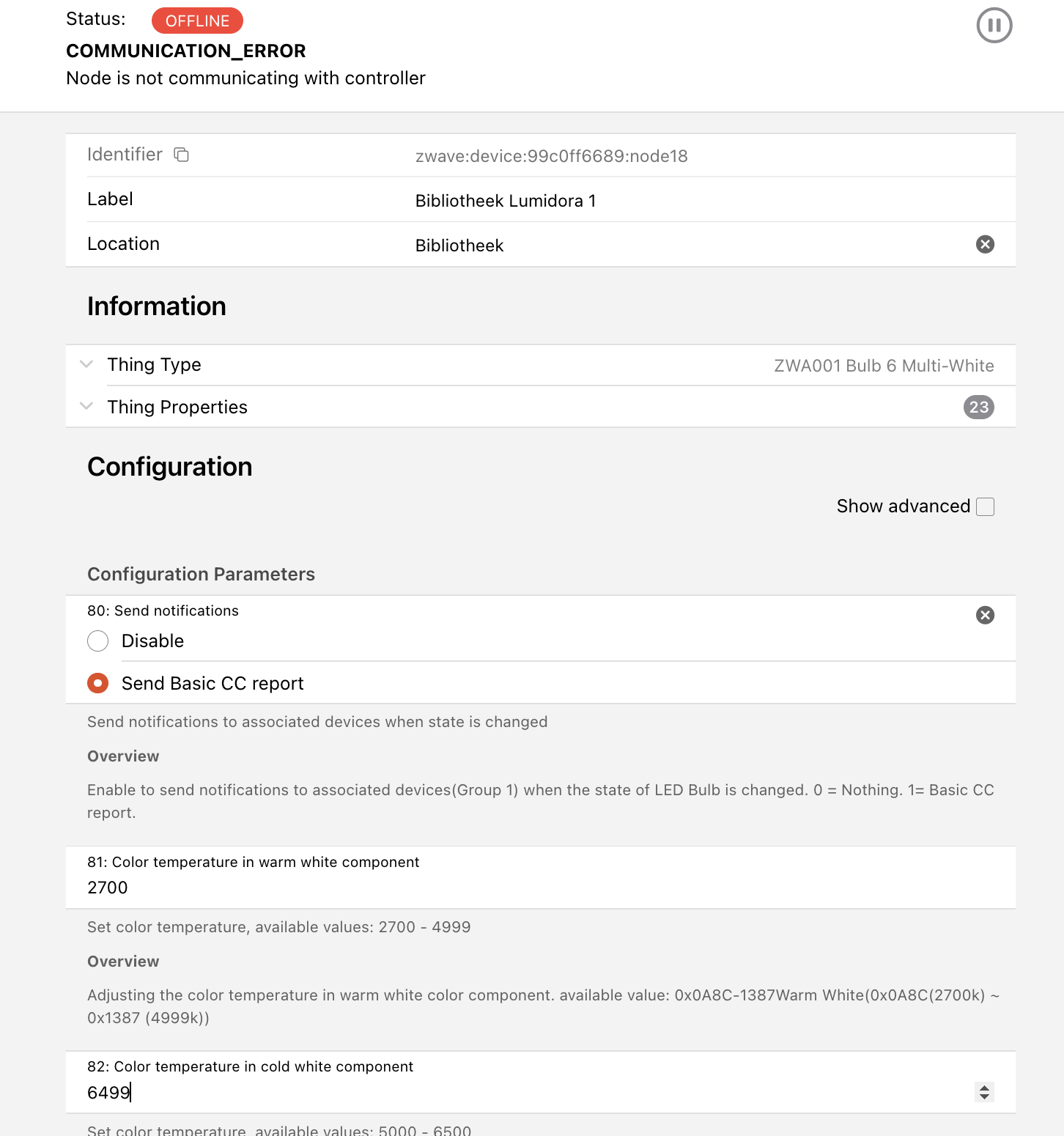

I have an Aeotec Lightbulb that is defined a follows and is unable to communicatie with the controller and vice versa:
Now the 82: Color temperature in cold white component is set at 6500. and the communication fails. If I change the value to 6499 the bulb is communicating.

It has been going on for a couple of weeks now that my devices get unresponsive. I used to be able to fix this by doing a soft reset. But a couple of days ago it started getting difficult in keeping the system working.
Mostly after a reboot or updating the container to a newer version things will end up having communication errors.
I tried rebooting and the problem of devices losing communication reoccurred. Even the ones with 6499 for 82: Color temperature in cold white component. So that did not help.
Then it might not be that. Need some debug. From the picture the “pending” is a slight concern since for powered devices that should happen quickly. It could be transitory though. Could be communication related-Is it near the controller & is the controller away from any interference?. Does the device have 5 lines on the UI page?

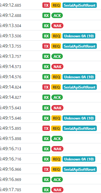

I haven’t encountered this before, so it might need some study. Anyway, it appears to be a controller related. If you use the zwave log viewer here the binding seems to want to reset the controller and the controller sends something related to RF. In the binding these are the serial classes
        SerialApiSoftReset(0x08, false, false, false), // Soft reset. Restarts Z-Wave chip
        RfReceiveMode(0x10), // Power down the RF section of the stick
Also the NAK is a concern.
case NAK:
                        // NAK means the controller didn't receive the message - probably because of a Checksum error
There seems to be many messages of Checksum errors.

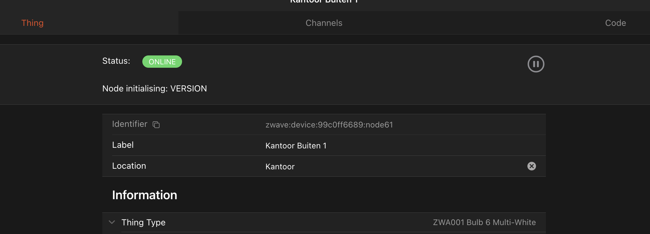

When reinitializing a device it also takes a long time to go past “VERSION”.

This is the amount of NAK’s (116 per minute) are registered in the Log file. All going to Node 255. Can this count for the insanely growing number of thread on my system as well?

Sorry to drop off there, I was upgrading to M4 and had problems.
I don’t know if he has time, but @chris need to look at this. It is beyond my experience and knowledge.

  2. From the debug log viewer extract in Post 7 doesn’t seem to work (assuming this was from OH)
What does such soft-reset execatly do?
It performs a unplug and plugin action.
I know it can be done from the UI. I would like to perform this from the cron if possible.
