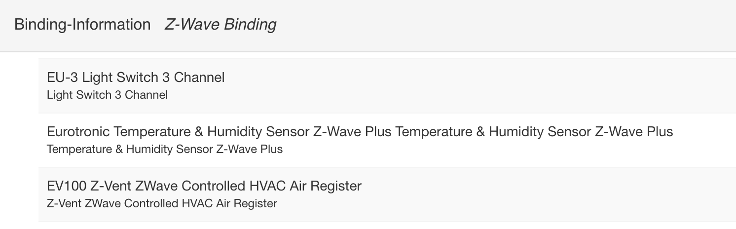

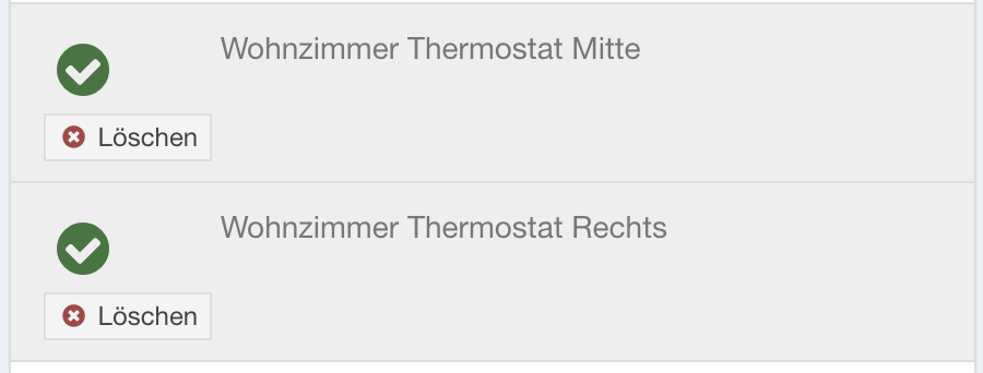

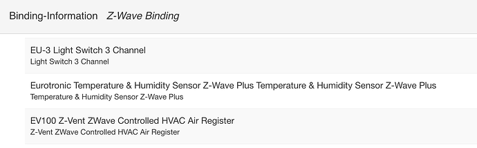

After Updating my OpenHAB to version 2.5.11 I’m not longer able to configure my Eurotronics Spirit Thermostats.
On Habmin:
Things are not accessible
In the Binding the device is not longer listed as a supported device. The only Eurotronics device listed is a Temperature Sensor

Please update to the latest zwave snapshot binding.
https://ci.openhab.org/view/Integration%20Builds%20(2.5.x)/job/openHAB2.5.x-ZWave/
I discovered, that the Z-Wave binding treats/discovers the Eurotronic Spirit as Unknown Device lately. I can’t tell since wich version it is that way. I discovered this behavior with the 2.5.11-1 (Release Build), wich I installed today. Also I tried the 2.5.12.202012141658 Snapshot of the Z-Wave binding with no difference to me.

Installed Z-Wave Binding 2.5.12.202012180333
All good again.
Thank you!
