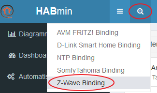

Are you sure that the other devices are not perhaps already included with another Z-Wave Stick? Just reset them (follow the manual of each device to do so) and then try to inlcude them again with OH. I do this with habmin by clicking

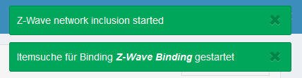

After that you should get a notification like this:
In this moment start the inlcusion mode of the Z-Wave device (i.e. click 3 times on a button or whatever the instruction tells you). Shortly afterwards the device should pop up in the Inbox.
