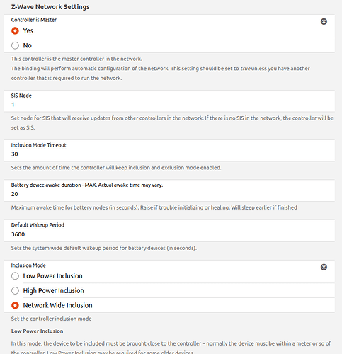

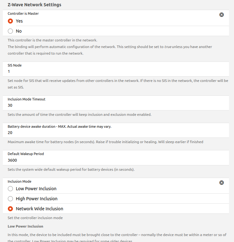

Is this the setting? It did not make any difference.
It seems 20 is the max allowed.
20 is max and should be plenty. I would need to see a debug file of an “awake”. I’m suspecting it is not sending “awake” but a NIF. What does the manual say for “awake”? Sometimes when it says three presses, only one is needed. Maybe just remove the battery, wait a bit and reinstall. The last option would be to exclude and try from the beginning with one device.
