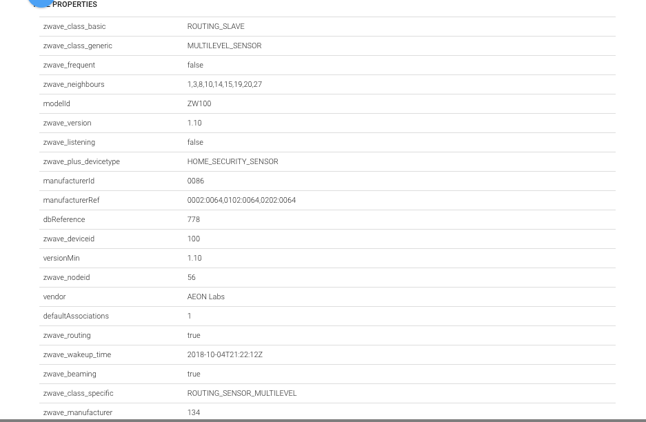

Can you also provide the properties of the devices.

I don’t remember if I had it connected to a power source or not when I included it. I can remove/include it again to see if that works. Which properties are you interested in?
HABmin will show a list of properties for the device - if you can provide an image of those for the two devices it might be useful.

Sorry - it’s not the configuration parameters - it’s the properties I wanted to see. These are listed separately in both HABmin and PaperUI.
My bad, here you go.
