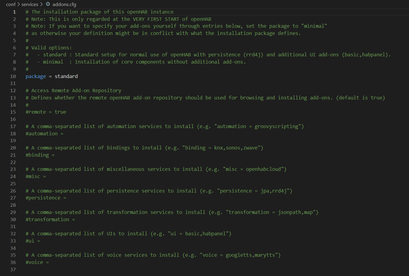

Hello, I try another way to check my PC and Internet access, I moved my current openhab folder to another place, after I copy (in disc C:) the same openHab that I download and run about 2 months ago and do first start.
1. I run a clean openHab 3.2.0 (the same openHab that I download and run about 2 months ago)
2 After created admin account, I go to “Settings > Bindings”
and, now, I can see “openHAB Distribution” (and many others in another category) very cool
In my current openHAB I can see just “Community MarketPlace”
This is my problem! The same PC and Windows
I don’t know if someone has this problem and where to find it, if I can’t make it work, I think to clean install OH3 because I config openhab in textual configuration and easy to restore
Thanks all for your help. (sorry for my English)
It shouldn’t make a difference but one time you login via your local PCs IP address and the other time via myopenhab.org. What if you use the loal IP address approach for the case that currently is not working ?
Just some weird idea: Are you login in to the same installation/instance or could it be that you have another OH running somehow, maybe from earlier testing? Did you check if it is really the same? (localhost vs. IP-address…)
Stupid question, but those have to be asked as well …
Thanks for replay, (I know that any factor change the result) all test I made(with installed oh3 and clean oh3) at home in lan network with host pc with oh3 (localhost) second pc and from mobile phone(lan ip) , and from mobile phone data (myopenhab, without wifi).
Not changed IPS, PC or other. The same internet provider, the same router, the same pc and the same windows 7 and java zulu that was installed, not changed nothing.
I just moved and renamed oh3 folder from disc C: and put clean oh3 that I download (about 2 months when I decided change 2.5 to 3.2.0 version).
I only think that the windows maybe make updates or anything else and broke or restrict something in openhab and it
not have access to openHAB Distribution (with official bindings). Maybe exist in oh3 a file or an log that I can compare?
