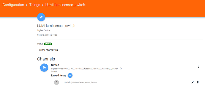

I Have a problem getting an Aqara mini switch (zigbee) to work.
The switch pairs and registers correctly (seems) in openhab, but oin pressing the button nothing comes in the eventlog, and after enabling debugging for zigbee some messages come in the openhab.log. I’m not sure but it seems the command send from the zigbee device is not recognised. I’m ruinning openhab on ubuntu 18.04 with the repositry to the testing branch. At this moment all bindings seem to be 2.5.9.
Relevant part of the openhab.log (I think).

Any idea what might be wrong? I removed and rediscoverd the device several times.
