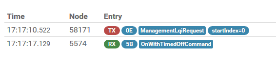

There is nothing in your first debug log and the second one looks like this:
grafik
I have no experience with Zigbee so we need to ping @chris and ask for some of his valuable time.
This command being used by this device will not work in the old binding. You should use a new snapshot and hopefully this will be resolved.
