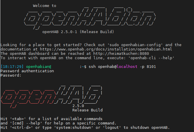

Additional Info:
openhab> bundle:list | grep -i zigbee
259 │ Active │ 80 │ 1.2.3 │ com.zsmartsystems.zigbee
260 │ Active │ 80 │ 1.2.3 │ com.zsmartsystems.zigbee.dongle.cc2531
261 │ Active │ 80 │ 1.2.3 │ com.zsmartsystems.zigbee.dongle.ember
262 │ Active │ 80 │ 1.2.3 │ com.zsmartsystems.zigbee.dongle.telegesis
263 │ Active │ 80 │ 1.2.3 │ com.zsmartsystems.zigbee.dongle.xbee
264 │ Active │ 80 │ 2.5.0 │ openHAB Add-ons :: Bundles :: ZigBee Binding
265 │ Active │ 80 │ 2.5.0 │ openHAB Add-ons :: Bundles :: ZigBee CC2531 Bridge
266 │ Active │ 80 │ 2.5.0 │ openHAB Add-ons :: Bundles :: ZigBee Ember Bridge
267 │ Active │ 80 │ 2.5.0 │ openHAB Add-ons :: Bundles :: ZigBee Telegesis Bridge
268 │ Active │ 80 │ 2.5.0 │ openHAB Add-ons :: Bundles :: ZigBee XBee Bridge

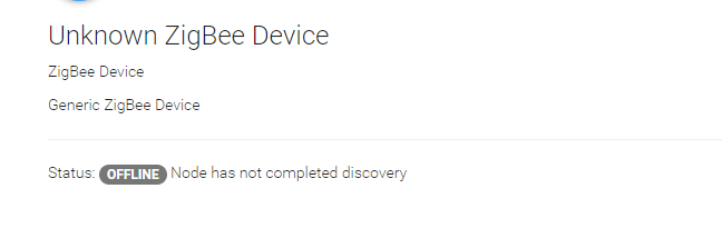

After another reboot device is detected again, but still offline. With another error “Node hat not completed discovery”. Any ideas?
Only one reboot needed and after that just restart OH.

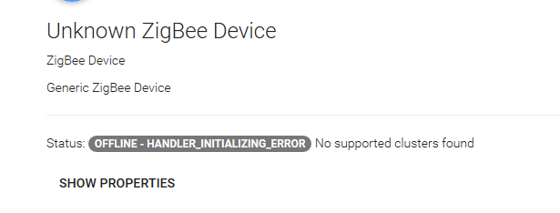

Just recently got one of these buttons and so far I haven’t been able to get it set up. Trying to get it working with a Nortek controller. So far none of the advice here has worked for me. Multiple OH restarts, multiple reboots (OH 3.1.0M4 on CentOS 8), tried adding while clicking the button multiple times and still can’t get it set up.
Every attempt so far results in the thing being created but no channels and a HANDLER_INITIALIZING_ERROR: “No supported clusters found.”
