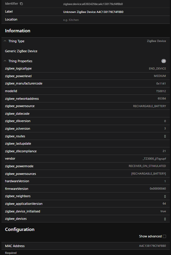

As you can see in the following screenshot the device is detected as “Generic Zigbee Device”:

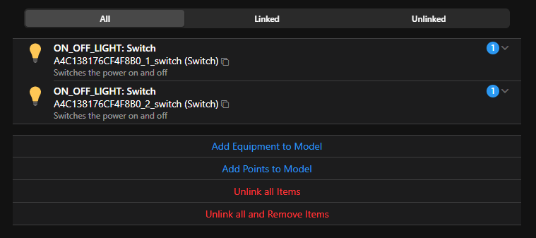

An this is what is shown in the Channel tab:
Should this parameter “power_on_behavior” appear in this channels list?

That’s correct - nearly all devices will be detected in this way as the binding uses a generic type, and then dynamically creates channels and configuration based on what features the device supports.
No - it is not a channel - it is a configuration of the ON/OFF channel. But it will only appear if the device supports the standard mechanism for setting this configuration.

And where this should appear? In the “Thing properties” section or in “Configuration” section from my first screenshot?

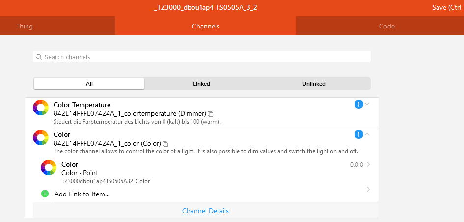

Neither. I’m not in front of a system right now, but from memory you need to click on the channel, and then somewhere there is an option to configure the channel.
Well, then first is to work out IF if it needed. Do you know WHAT is required yet? Does this device already support the standard features - if not how is it configured? You need to know this - or at least “I” need to know this to answer your question.
Yes, you are right, in the “Channel details” as @anon71759204 pointed out.
