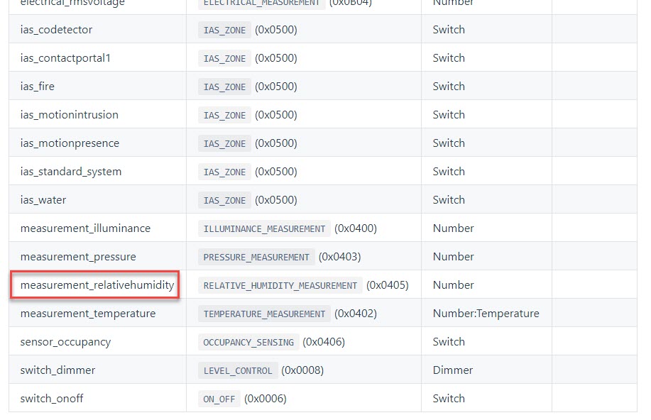

and I tested this (for adding humidity from channel types table here):
Number Humidity "Feibet_humidity" {channel="zigbee:device:ac9d1b5f:00124b0018dd053d:00124B0018DD053D_8_measurement_relativehumidity"}
but nothing appears in paper UI.
I swear to god that I copied the CUID from the paper UI. Additionally, nothing is said about that channel number (that 8). you can check the channel tables for Zigbee binding here.

Most likely these chinese cheap Xiaomi stuff will not report all their available channels…
It’s the endpoint number.
As I said earlier - the UI will show you the channels that the binding makes available. If the UI doesn’t show a channel, then the binding doesn’t provide support for that channel.
