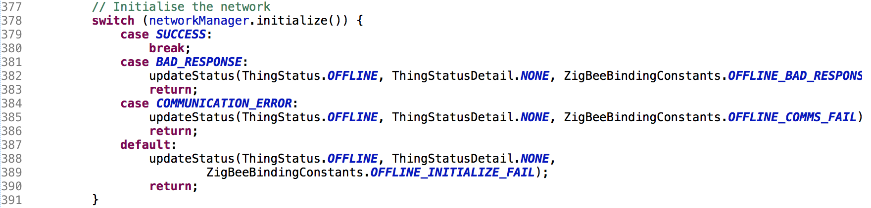

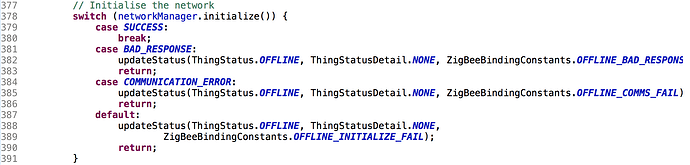

Well, if you want to try a test, then look at line 383 in ZigBeeCoordinator - this should be a return statement - change this to a break statement and (hopefully!) it should work (you might also need to comment out the updateStatus in line 382 - at least it won’t hurt to do this as well).
This is not the right solution, but it is a workaround without having to compile the libraries. Let me know how this goes…
