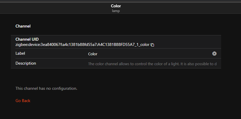

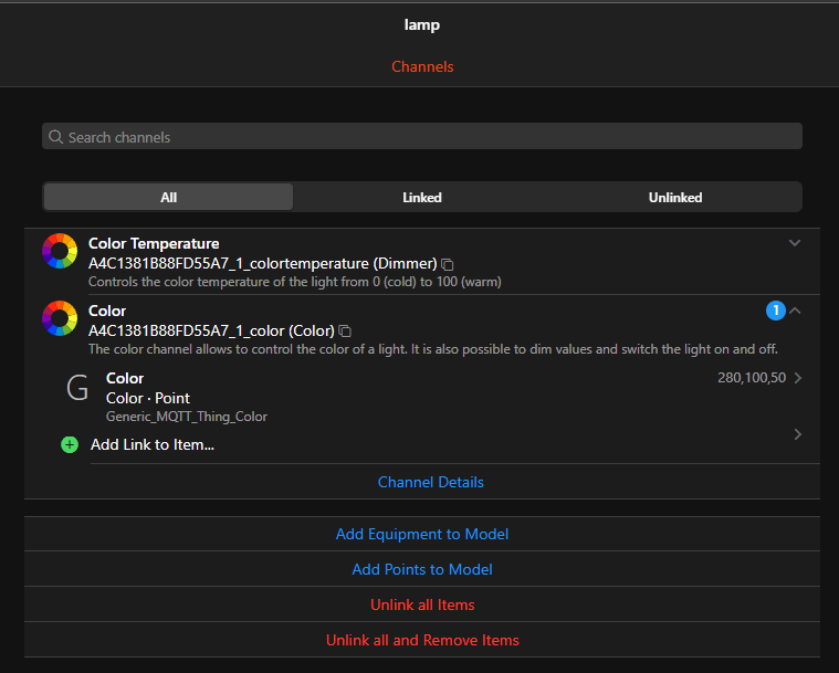

Zigbee bulb not changing colors
The issue may be here?
Channel zigbee:device:3ea840067f:a4c1381b88fd55a7:A4C1381B88FD55A7_1_color failed to initialise converter

See if you can configure the channel. There should be an option called “Color Control Method” - try setting it to HUE - or XY. It defaults to Auto, but in some cases this causes a problem if the bulb doesn’t report correctly. To get to the configuration, click on the Channel Details button in the channels list.
That is how I have it configured at least I think. I can post screens of the configuration tonight.

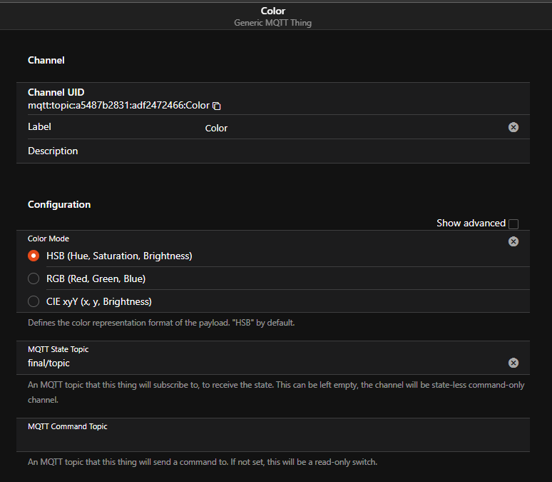

I have the colors coming across (via MQTT) as HSB values (H, S, B). The working lights don’t seem to care, they change with both (R, G, B) or (H, S, B). I don’t think I have tried XY, but I did see elsewhere in the log when I had it configured as RGB, there were messages like: value for brightness is out of range (should be between 0-100) So I am pretty sure the bulb is looking for HSB.
I think it’s worth checking. I’m not talking about the item configuration here - this is the channel configuration - it’s the commands that the binding uses to communicate with the device. RGB is not an option - it’s either HUE, or XY. The binding converts to the appropriate commands for the device, but the problem is that the binding for some reason cannot detect what commands this device requires.
this channel has no configuration?
The first image is not related since it’s a different thing completely.
I’m not sure why it has no configuration - possibly because it isn’t initialised. It looks like it might be a catch 22 - you can’t configure this as it’s not initialised, but it’s not initialised because it can’t detect the supported colour commands.
I think what I’ll do is change this so that instead of failing the initialisation if it can’t properly detect the devices features, it instead defaults to using Hue commands.
