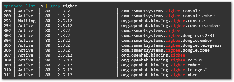

There is a script that might help.
Thanks a lot.
I did it, but I am a little confused about the result, showing that:
The line with “Waiting” is confusing me.
But besides that confusion:
It is running much more stable and longer as before. Means, since the restart the CC2531 is “online” and remains online. It is sometimes flickering into “uninitialized” to “unknown” for maybe 1 second and then it comes back as “online” again.
UPDATE:
After 19 minutes online time of the Cotainer it is again “uninitialized” and remains in that stage
You still have the same problem - you are running an old version of the dependencies (the zigbee libraries, which are 1.3.2) and a new version of the binding. The line that is “waiting” is probably upset as it is looking for classes that don’t exist in the old version of the libraries you are running. The others are probably resolving, but 1.3.2 is 12 months old and I don’t remember what has changed (a lot though).

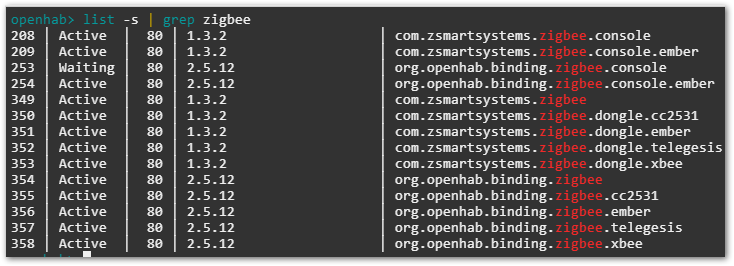

I did it now again in single steps. Means: using the mentioned script to uninstall the binding.
After seeing the success, restarting OH container just to be sure.
Running then the script again to install it.
Again restart of OH container.
Now the result is different, which is promissing:
At the moment it is “online”. We will see what happens.

It’s hard to know what is happening here as you now have 3 versions running.
Ok, my only other suggestion above was to use the debug logs, but if you don’t want to go down that route then a fresh install might help - or it might not - it depends on what is causing the problem and this is what the logs would help you with.

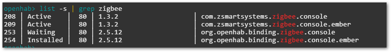

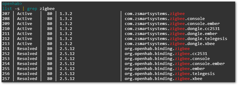

I did again the uninstall part of the script, because if I got you correct, I should first of all get rid of the former installation(s).
It was prompting success. Then I did a first check:
Hm… still something left. But ok, let’s restart the container and do it again:
The lines are back like zombies…
Ok, did I miss somehting? reading the md-file again, I do not see, what I’ve not done so far.
