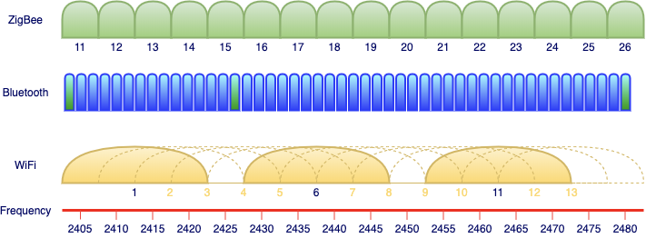

By this, I mean that the 2.4 GHz spectrum is used by WiFi, BLE, DECT, 802.15.4 etc, etc. Each protocol allocates the complete spectrum, and the question is what channels you and your neighbours are using. Normally it’s possible to find a clear channel, but I can’t tell you which one it will be in your house.
I know that a large hotel chain use ZigBee in some hotels and it works well. They have a separate network for each room and also have WiFi throughout the hotel and it all co-exists well.
this article explains the channels well: ZigBee and Wi-Fi Coexistence | MetaGeek

I meant to post this earlier - this is a chart I use when I’m doing ZigBee training that shows the frequencies-:

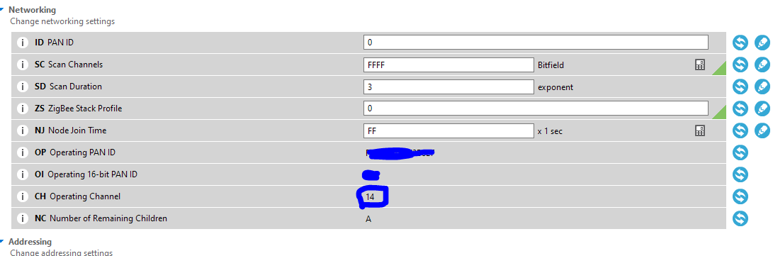

I now used the Digi Software XCTU and flashed to a newer version
Now I could configure the device a little further
but more newbie questions come up :smiley:

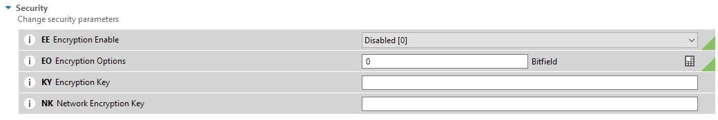

→ it allows me to disable security. Can I use it without in the binding? and is it advisable?

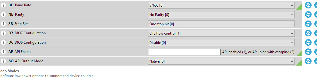

→ must the config for Baud Rate and e.g. CTS flow control match my thing definiton in openhab?
→ I cant edit the channel (after flashing the firmware its 14). anyone who knows this tool better if I can change it somewhere?

ZigBee won’t work without security so I’d recommend not to do this. ZigBee uses multiple layers of security, but pretty much everything requires at least transport layer security.
Yes - this allows you to configure the S2 to some definition. You then need to make the binding exactly the same configuration so that the binding can communicate with the stick.
Sorry - I’m not sure about that.

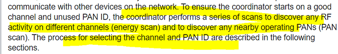

I read more docu from DIGI now and it says their ZB series of zigbee coordinators scans the channels and selects automatically one which is not so crowded …
you said before to change a channel is not a good idea so I hope the firmware got a good glass bowl to know which channel stays less crowded in the future :wink:
I don’t think the firmware will change the channel - Embers don’t typically do this and I’d be a little surprised if Digi decided to change the Ember default too much - I think they’ve basically just added a different API.

yes I meant to say it does a scan and self detects a good channel
Currently the binding does this when creating a new network, but it will still use the channel that you request rather than the quietest channel - it’s something I need to change when I get a chance…
