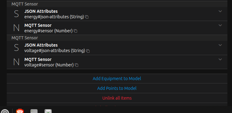

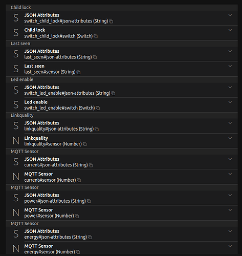

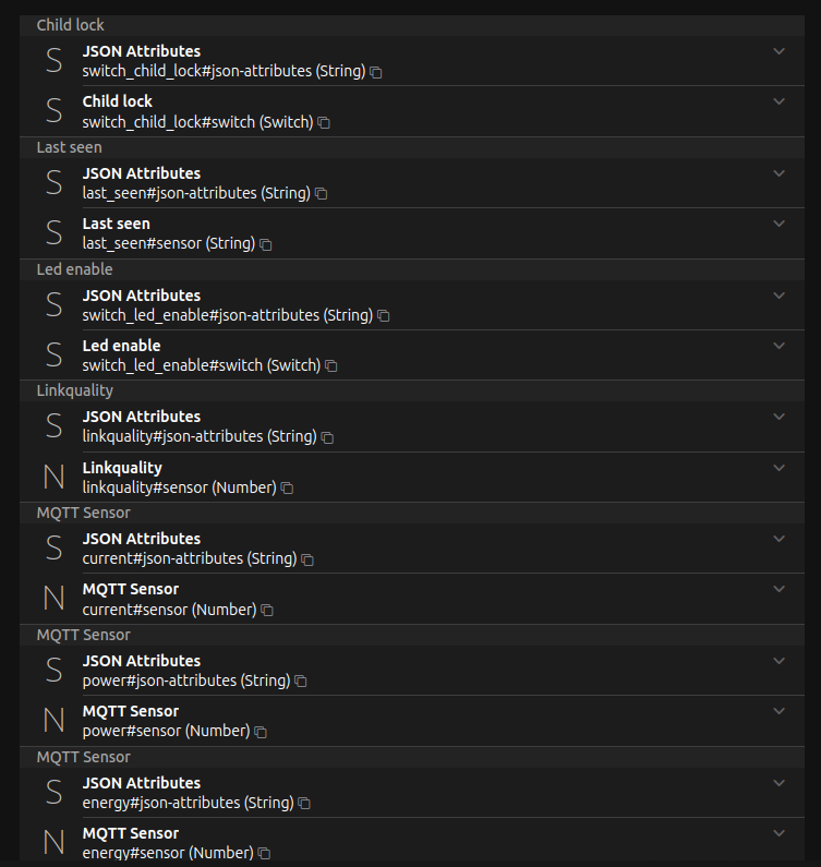

Update Forgot to mention: in the UI, I can only see 4 channels (standard view):
And in advanced:
I don’t know if it matters or not, I also saw in openhab.log this row related to my thing:

Hello everyone,
moving to OH 3.4.1 and z2m 2.0.0 I see a similar behavior for my metering plugs (different case with Gerrman Plug) but same device).
The HA config information I receive from z2m contains the information about the switch (allowing to toggle between ON and OFF), but the actual Channel for the switch item is no being created for the Thing. But the channel to en/disable the physical switch is present as a switch, so this is something hardware independant I assume.
Config for the switch as seen on the broker:

  • Seems it if considering the switch/0x70b3d52b600fb9a1/switch_child_lock but ignoring the switch/0x70b3d52b600fb9a1/switch
  • Triggers for ON / OFF are available as well.
  • In z2m controling the device is possible, no problem there.
  • I receive e.g., power or current data from the device in z2m and OH, so communication is working in general
The behavior is the same for other plugs too, so sounds like “only” the switch is having an issue.
Already deleted the Thing and rediscovering it showed the same result - the power switch channel is still missing.
Any Ideas?
