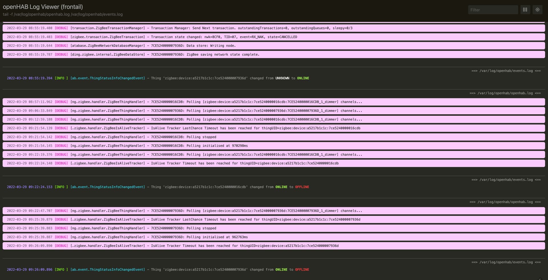

I upped the logging for Zigbee and this is what I am seeing in the logs, not sure if anyone looking at this can make sense of it.
You need to get debug logging to work out what is happening. The small log you show as an image above really doesn’t help - this is the endgame you’re seeing here. It shows that the device is not reporting, and the binding doesn’t get a response to the poll, so after all of this, the binding will mark the device offline.
All I can say here is that the device is not responding, or not reporting. If the device is a battery device, then maybe it won’t respond to polling. It still should send reports, but really this is down to how the device got configured when it was joined to the network - if it’s not reporting, then it will be marked offline.

I have captured this screenshot with some logs. You can see it stops polling and then they go offline.
It’s hard to comment too much without log files, but it seems that the device is no longer responding, so the binding marks the device as OFFLINE - this is exactly what it should do :slight_smile:. If it was working for quite a while without problems, then probably there is a communication issue in the network.
