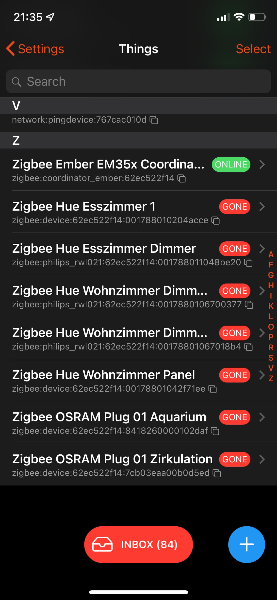

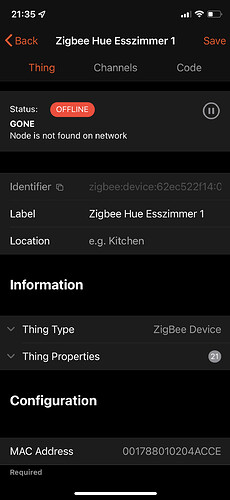

I‘ve wanted to change the Zigbee Channel from 11 to 18. After I did it everything went to „gone“ state.
What do I have to do to bring them back online?
Error says: Node is not found on network
THX

Hi all,
@rossko57 : I had some patience (9 hours) but all remain on gone
@chris : The Panel in my Living Room (Hue) is always connected to power as well as several OSRAM Smart plugs. None of them where coming back.
In the end I reconnected all by reset => But okay it’s only a one time action.
