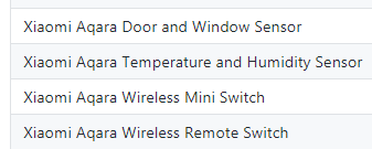

The Aqara WSDCGQ11LM Temperature Humidity Sensor (the square one) works fine for me, beside that the pairing could be a bit annoying.
The Xiaomi Mijia Temperature and Humidity Sensor (the round one) don’t work. I could pair them, but they only get updated once during discovery.
I’ve personally tried the door sensors, and the temperature/humidity sensors. I can always suggest reading the documentation as it does list some devices even if it’s probably incomplete -:
