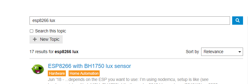

I ended up building my own lux/pressure/humidity/temperature sensors for ~$5US each and I have full control of the firmware. This is a great project for kids! One of these days I’ll write up a tutorial for them, but I plan to add some form of presence detection first. Some related info…
https://community.openhab.org/search?context=topic&context_id=99980&q=esp8266%20lux&skip_context=true
@5iver That search link does not work.
I disagree
Weird.
In Chrome, clicking on it gives an error. Opening in a new tab works.
In a new tab
