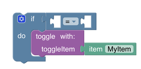

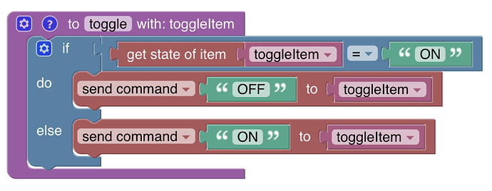

There are of course alternative approaches that could take less copy and paste. Or at a minimum shorten this a bit.
For example, you can create a function called “toggle” which encapsulates the “if ON send command OFF else send command ON” part.
Then in your if statements all you need to do is call this function with the name of the Item that goes with the scene.
