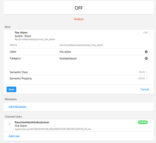

I have auto discovered the smoke detectors and added items “automatically” to my model.
It seems to work, but i cannot switch on the siren: the item “Fire Alarm” was added as “Switch”, but there is only the text “OFF” - no Switch?!

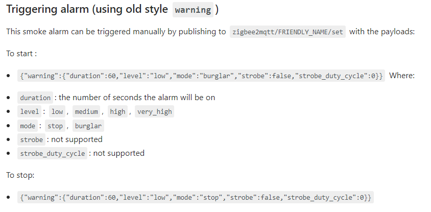

On zigbee2mqtt i found a documentation for this device:
Blockquote
Triggering alarm, Simple
Can be set by publishing to zigbee2mqtt/FRIENDLY_NAME/set with payload {“alarm”: “START”} and {“alarm”: “OFF”} Set max_duration from the Zigbee2MQTT UI or by publishing {“max_duration”: NEW_VALUE} This alarm are preset to highest volume

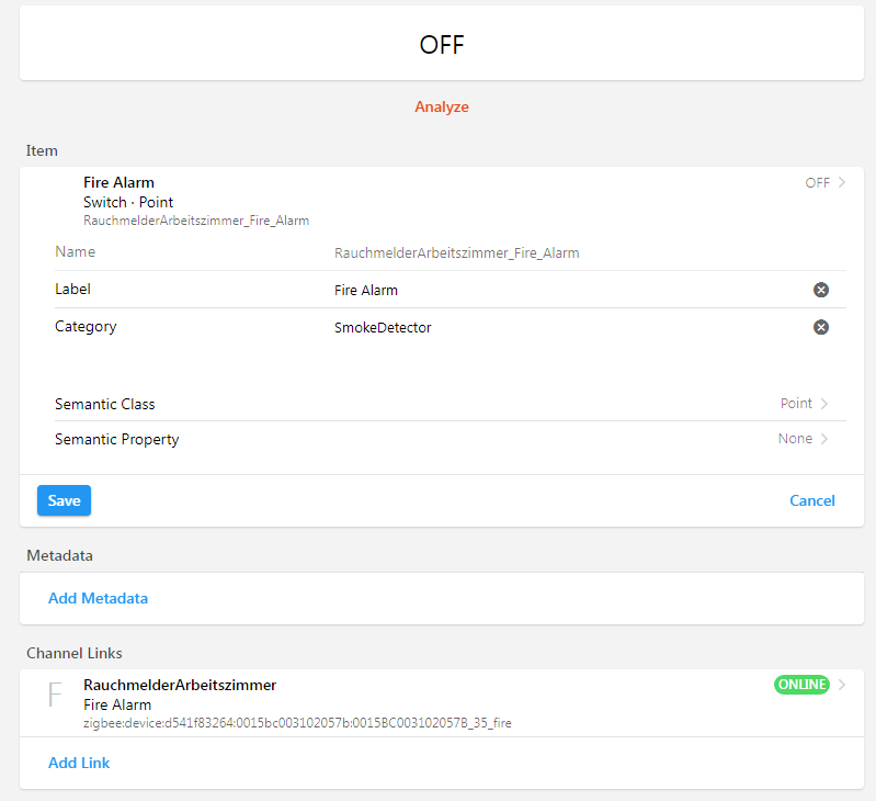

Another Screenshot:
The configuration of the item:
label: Fire Alarm
type: Switch
category: SmokeDetector
groupNames:
  - RauchmelderArbeitszimmer
groupType: None
function: null
tags:
  - Point

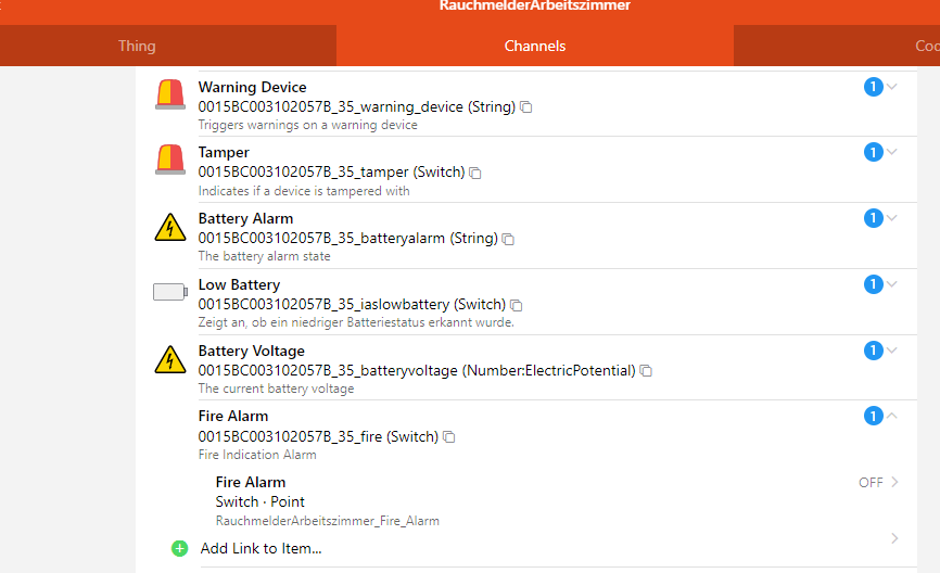

I don’t have this device, but from the zigbee2mqtt documentation I would think you need to send JSON arguments to the Warning Device channel.
Since OH recognizes the Fire Alarm channel as a switch (not a string), I’m guessing that the “Triggering alarm, Simple” method in the z2m documentation doesn’t work. OH wouldn’t know how to send START to switch item.

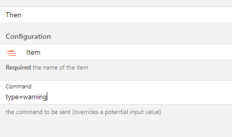

Thanks, you are right: to switch on the siren, send a command “type=warning” to the “warning device”:
I think i got it now::
Item ‘RauchmelderArbeitszimmer_Fire_Alarm’ changed from OFF to ON
This seems to be a read-only switch. I can create rules for that event and send the “warning command” to trigger sirens in other rooms.
