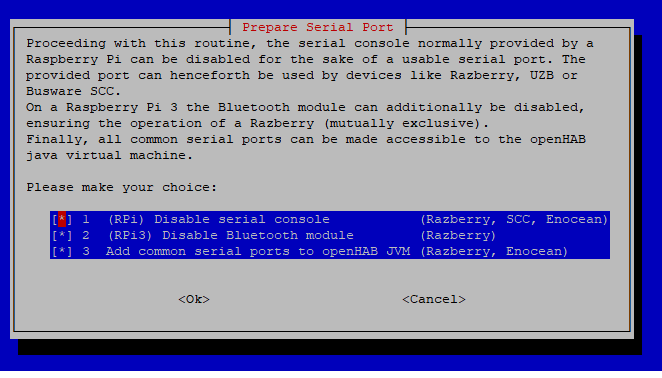

Just had an idea..
Did you change the serial settings from the openhabian-config ?? If not, if might be worth a try.
It´s menu option 35. These are my settings:
Yes, all options are checked to no effect, unfortunately. Thank you though :slight_smile:
It is very odd, cause I have the ACM0 serial port just fine.. I had no more ideas :frowning:
