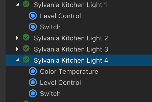

Wondered why the temp is stuck on my lights, noticed the channels have disappeared for 3/4 of them, still present for the 4th light? How does this happen? How can I fix it? These were autodiscovered.

Nothing in the logs unfortunately. My items are in .items files fortunately, so I can see the channels in there, eg:
Dimmer   SylvaniaKitchenLight1_F0D1B8000002ADC81Colortemperature   "Color Temperature" (KitchenLightsTemperature)  {channel="zigbee:device:5b077569:f0d1b8000002adc8:F0D1B8000002ADC8_1_colortemperature"}
Dimmer   SylvaniaKitchenLight1_F0D1B8000002ADC81Dimmer             "Level Control"     (KitchenLights)  {channel="zigbee:device:5b077569:f0d1b8000002adc8:F0D1B8000002ADC8_1_dimmer"}
Switch   SylvaniaKitchenLight1_F0D1B8000002ADC81Switch             "Switch"            (KitchenLights)  {channel="zigbee:device:5b077569:f0d1b8000002adc8:F0D1B8000002ADC8_1_switch"}

Resolved this by adding the channels back in the JSONDB … just copied and modified from the one light that still had the channel.
